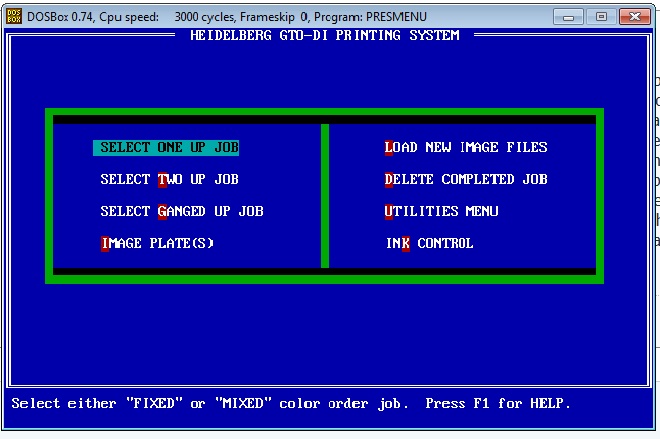

Here is a pic of the program, there are utils that tampers with density adjustment but i think it affects the laser imaging.
There is a way to change the characteristic curves but i think its only for ductor strokes in accordance to speed -all zones button+flashing warning button+1/2/3/4 station and +/- buttons till +99%/-99%-. I guess its the very first try of Presstek/Heidelberg to make this thing work
Select the Utilities menu and see if there is a sub-menu that might be called Ink Curves or Ink compensation. You might have the option of adjusting your ink values up or down and save them into a memory titled M1, M2, M3 etc, On the QM Di they had a Special Functions button with sub menus where you fix the register adjust diodes etc there were nine memories available where different compensations could be entered and saved to account for different ink manufacturers. I think that the Utilites is where you be looking to help you with this problem.
