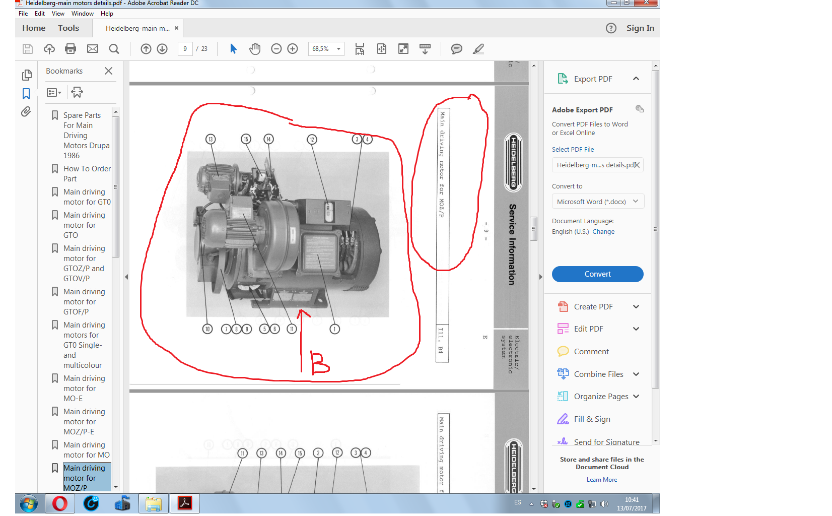

What type is your Motor? Baumuller or Dietz?
As electrical and electronic engineer P.E tha i am with over 45 years in troubleshooitng Graphic Arts Industry, and trained
by Heidelberg, Polar and other, Now retired.There many possibilities.
As you indicate if you rebuilt the motor: 1) I Do not know if you put a new windings?? if You do it exist the possibility
that number of wires crossing is be Wrong. and Inmediately that WILL NOT permit to reach the Speed 11.500IPH.
2) If you did not, and the motor is the Baumuller with servo-motor integrated and Microswitch. The timING is Wrong, the lever
will be Bad ajustmenT , the microswiths will NOT open and closed according with his Schematic Diagrams
Let me know if you have, may a can supply after you answer me, what can1) Motor do you have 2) if you did put New winding ?

Thanks for the input Chock. The motor is Baumuller, and we did not have new winding put in. The company that rebuilt it for us said they only put new brushes in, cleaned everything up, and double checked that the motor was functioning through its full range. They were not able to use the servo-motor/microswitch control to spool it up and down, we had them in today to help us diagnose the problem as well, the guy they sent us didn't think anything was wrong with the motor as when we disconnected it from the press, we were able to run it through its full range without any issues. The issues start when we have the load of the press on it. I'm going to contact Heidelberg and have them send us a tech if we can't figure it out within the next day or so...
