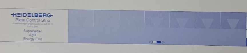

Hi.
I' m from Thailand.I can't find how to read meaning this zone on plate control strip when under or over developing or exposure.
Thank you for your kindness
Find the visual match between the foreground triangle and background. As you change exposure or processing, the triangle will move left or right. Mfg often recommends a certain value.
