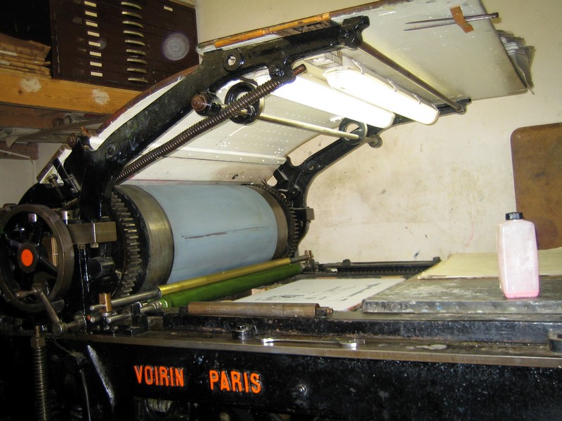

The last sheet-fed press I worked on was a French - Voirin Press ! - - so I decline giving my opinion on the merits of Heidelberg - V - Komori and the rest, but the Fidelity of Dot Reproduction on any press also depends on Plates/Blankets, Ink and Paper not forgetting the competence of the printer, neither of which any press manufacturer make.
Regards, Alois
