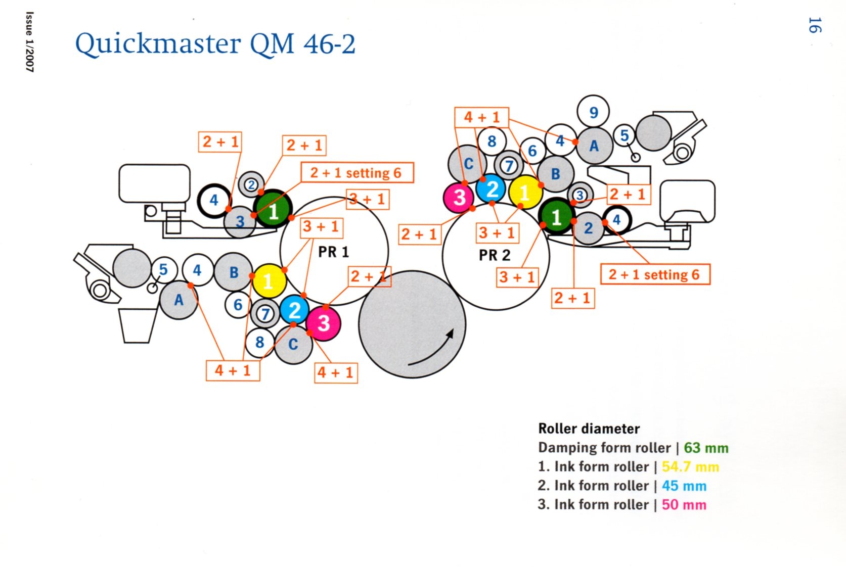

Hi. I was just looking at a diagram of the 46-2 roller train. I wanted to confirm to myself that it was a common blanket press. That arrangement might cause extra water from the first print unit to go to the second via the blanket. Try not printing with the first unit and see if the second unit still gets too much water.
I also noticed from the diagram something that surprised me. I had not noticed it before. In that diagram, the water feed to the plate is applied after the ink is applied to the plate. In just about every other press roller train I have seen, it is almost always water first and then ink to the plate. It is also possible that this diagram is wrong.
So if this the arrangement you have, maybe that is making it harder to solve. I don't know, just an observation.

The diagram in the "Heidelberg - Profi Tip Booklet" of the Quickmaster QM 46-2 IS the wrong way round (Gear Side View)
All Sheet-fed Presses the paper path runs Right to Left, remember that most Human Beings are Right Handed !
Dampening is "Water first"
But most of the Web Offset Presses, run of paper is left to right
Regards, Alois

Alois, I was using the arrow on the blanket cylinder for the direction as a reference. Plus I misread the diagram. Both units have the same order. I tried to post the image but was not successful the first time. I shall try again.
Success. This was the first time I have provided an image or attachment in a post. That makes my day.
Big surprise. Alois, I hope you can see from the image, there is confusion on the issue. It turns out that in this Heidelberg PDF, they got the rotation of the Blanket cylinder wrong. It is backwards. The arrow is in the wrong direction.
All is well again. Water first then ink to the plate. :-)
The image is on page 17.

Thanks for your diagram. Easier to see for everyone than my posting of the whole PDF.
Your diagram still shows that the plate is inked first before it is applied with fountain solution. I think they got the arrow direction wrong for the blanket cylinder rotation. Can anyone confirm what is the correct direction?

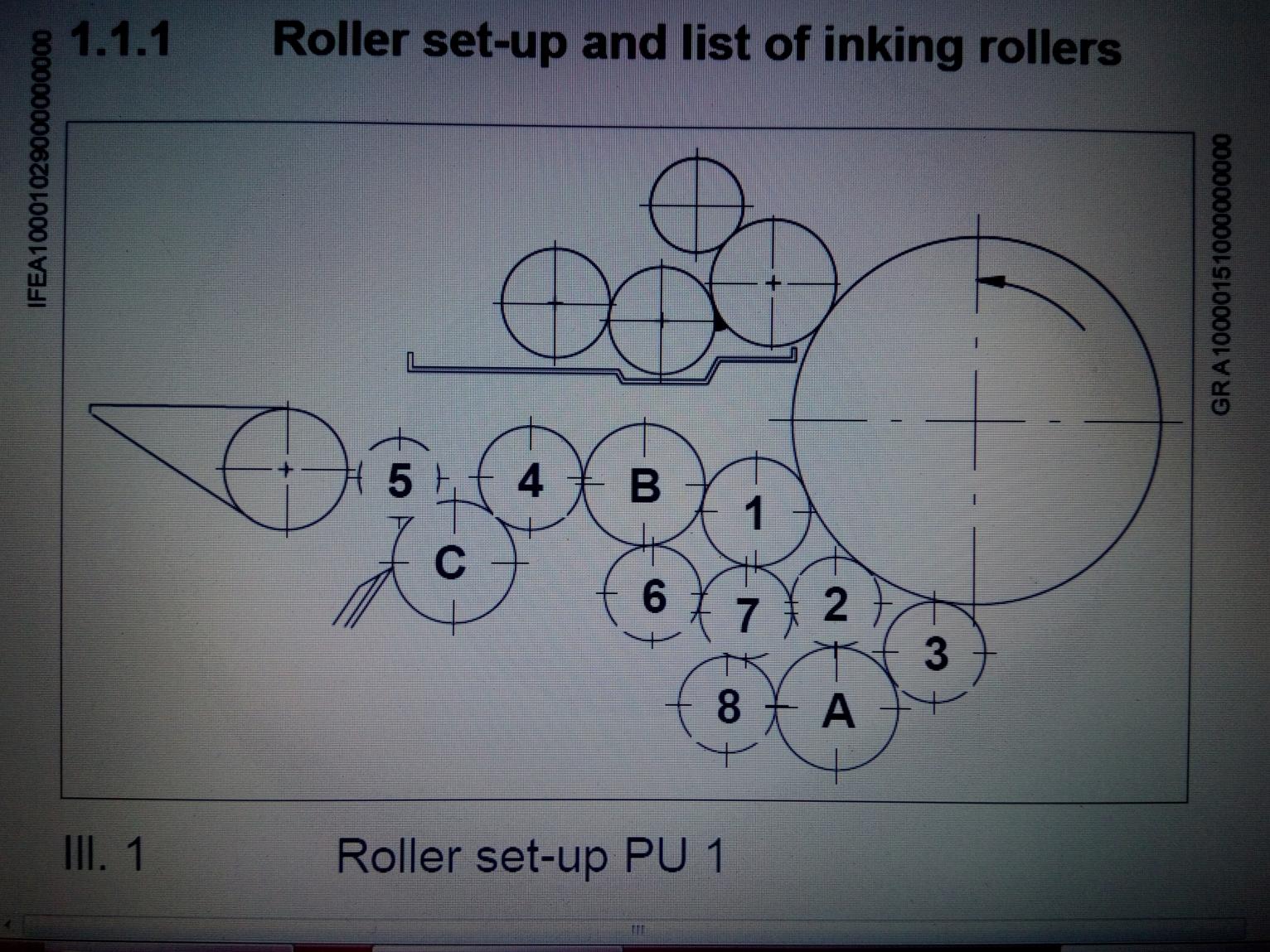

Erik,
Look at the QM 46 - 2 PDF same post, re Rotation of Blanket Cylinder
Yes, the rotation of the blanket cylinder is counter clockwise and therefore the rotation of both plate cylinders must be clockwise and that means that the ink form rollers are inking the plate before the water is applied on both units. I think the arrow on the diagram for the rotation of the blanket cylinder was a mistake. It looks that way to me.

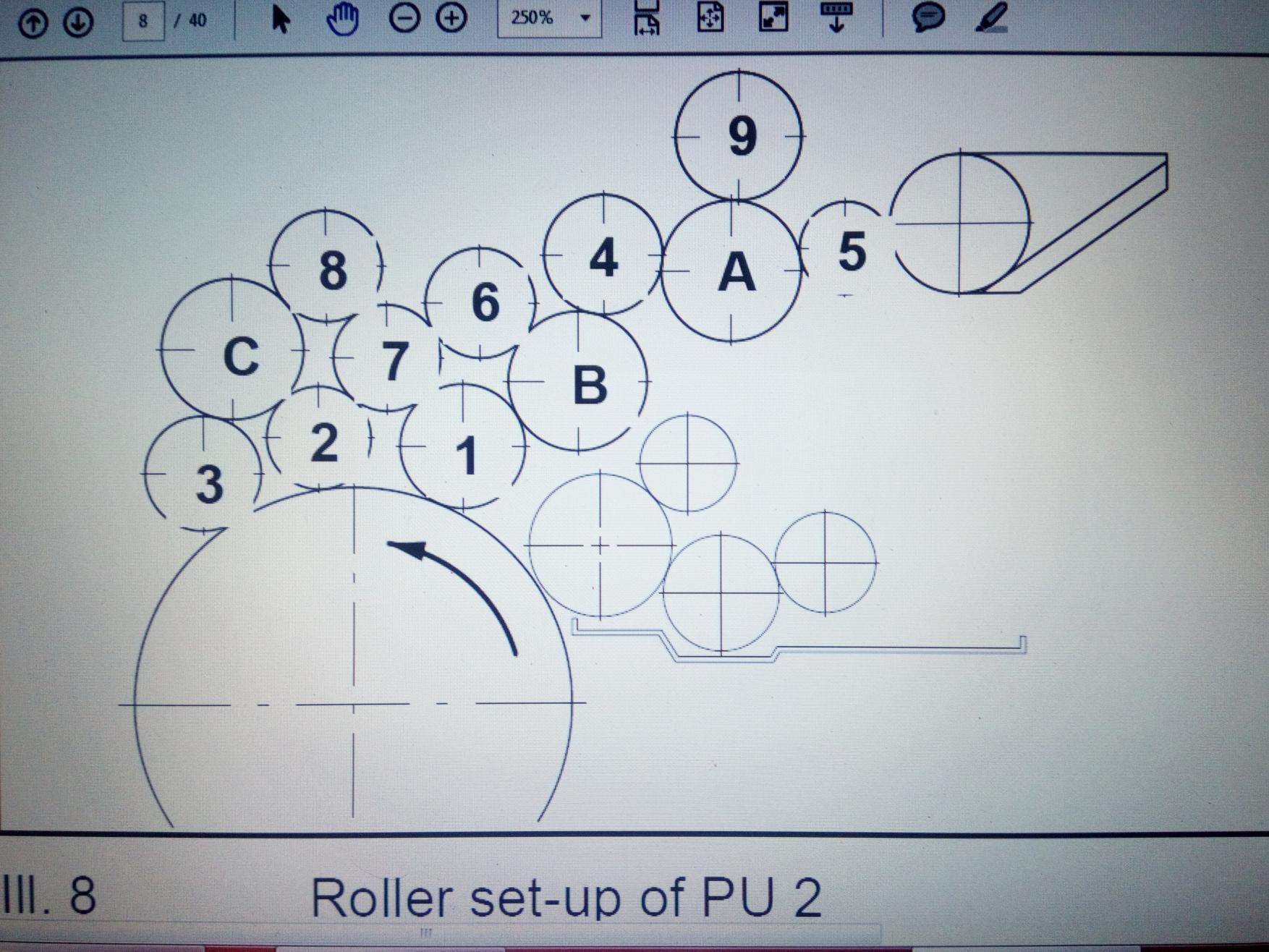

Just to confirm the cylinder rotation for all members here,

Erik, ERIK !
I suggest you LOOK again at the PDF........ On the right above the feeder IS Print Unit 1 --- the rotation of the plate Cylinder is anti- clockwise YES ?
then look at the roller train diagram, you will see the Dampening System Highlighted in CYAN
AGAIN - all Offset Lithographic Printing Presses use Water First System.
Regards, Alois
Hi Asif, yes your diagram has the correct rotation. For some reason, Heidelberg made a mistake on the other diagram with the rotation direction of the blanket cylinder. Nothing to do with press orientation. When such simple issues are such a problem to see, it is understandable that more complicated issues are even more difficult to grasp. Thanks for your proper diagram. It confirms the correct rotation of the plate cylinder with respect to the inking and dampening rollers.
