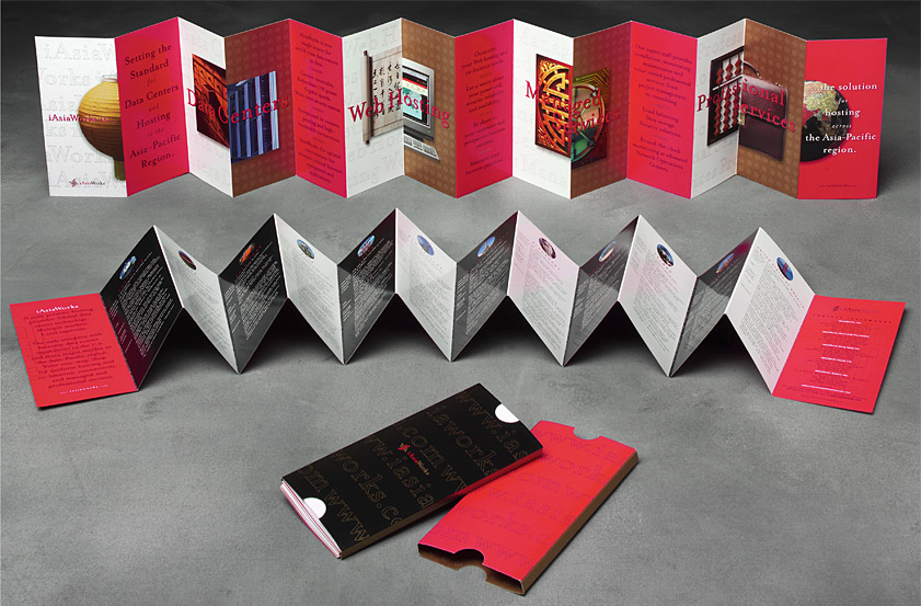

Hello,
I'm very new to the commercial printing space and am finding it extremely difficult to find and weigh out the different qualities of the various types of printers. I'd like to explain what I am trying to do and with that information try and narrow down some specific models/types of printers which may work for me.
I'm looking to do very low production run quantities, something along the lines of 1-50.
The print size is uniquely long and rectangular, approx 9 x 36" to 18 x 48"
The type of paper would primarily be a medium cardstock
The prints would contain photos/text on an array of background colors
The final product will be folded into an accordion style brochure very similar to the attached photo.
From what I've looked into, I've seen some large format printers that sound like they would work great. The Roland VersaUV LEC2-300 appears to be a good match as it has built in creasing/cutting/UV which would greatly simplify the post print production. The downside to this particular model is that it is moderately on the high-side for cost as this is a very small/startup operation. I'm not opposed to buying used.
Is there anything that I'm overlooking which may be a better fit for my needs? I have thought about partnering with a local print shop however due to the very low production run of these prints I feel like the margins would be far too stressed.
Thank you all for reading and I appreciate any/all suggestions!

@CaptainFill, with your low volumes and only needing 1-sided, an HP DesignJet Z9 24" model will work well (on sale now for $2,695). You will also need a rotary trimmer like this one to cut them to full bleed, and if they fold as shown in the photo, you should get a manual creaser for cleaner folds and to prevent cracking.
Thank you for the suggestion and accompanying finishing tooling! I keep feeling like the wide format route makes the most sense for my application, the model you suggested looks nice and priced in my alley. I understand that this wouldn't have a built in UV function however do you know with its "optional gloss enhancer" would it be able to create a glossy coating on cardstock material similar to the example photo? Thanks again!
