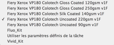

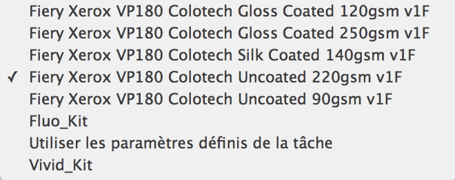

In the attached the output profile i have in the machine
most of the time i print coated 300gms or 350 gms but the result it's not so good
Thank you for your help

But do you select one of those profiles when in the job parameters of what you're printing?
If you're printing on 300gsm coated you should be setting that to gloss 250gsm for a better match.
