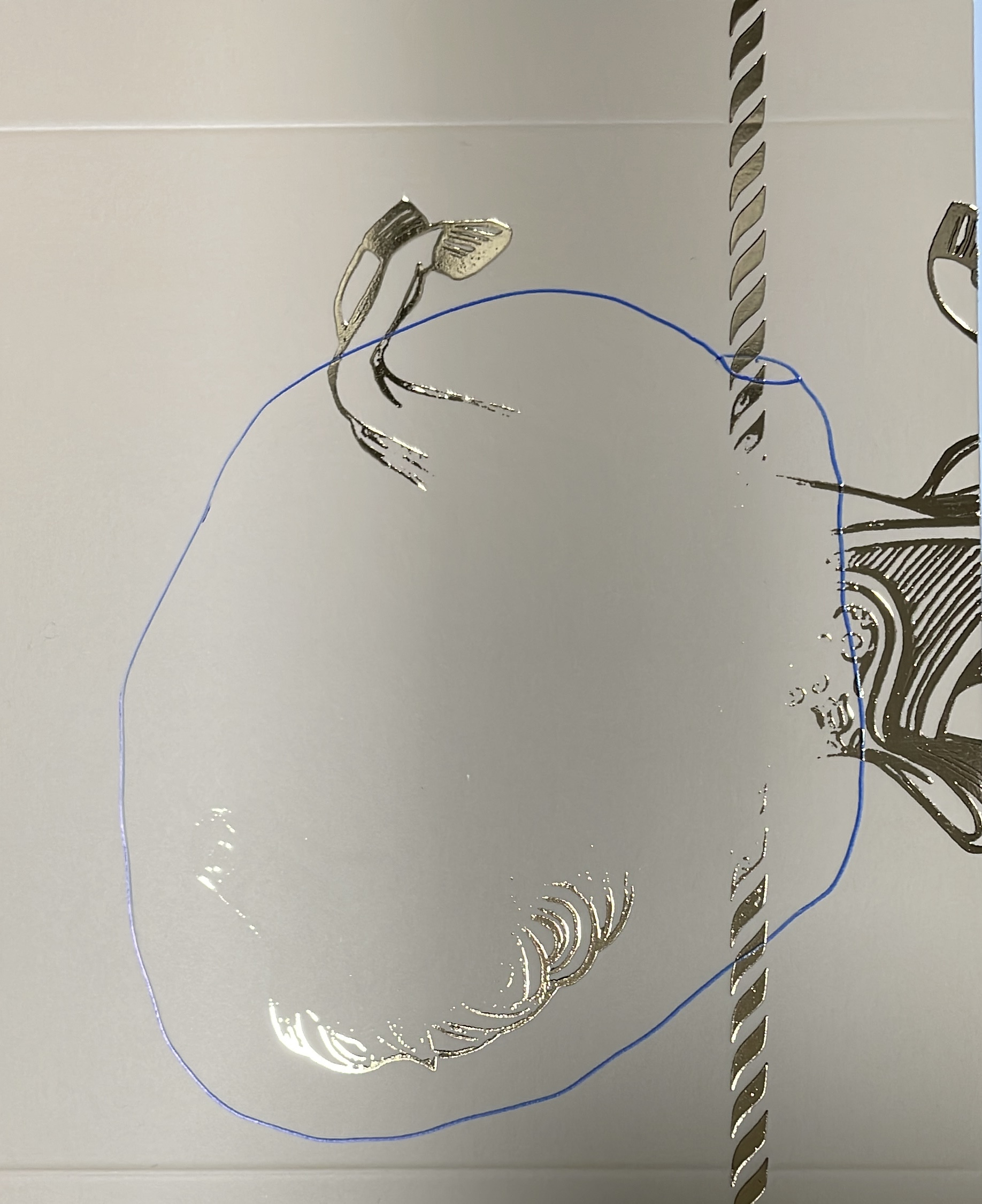

Hello, pls i have a pneumatic heat press to make hotfoil stamping
I have a problem when i work with large plate, some place dont stamp, pls what can be the problem ?
You need to "makeready" the areas not imaging/foiling.
Assuming your are using a phenolic board place some thin packing (plate tissue or packing about .002") under the phenolic in the necessary area(s).
Add more as needed.
Add more as needed.
Thank you for your answer, i can’t find makeready sheet in my country , i tried by a tape but the result not good i will try with very thin sheet
