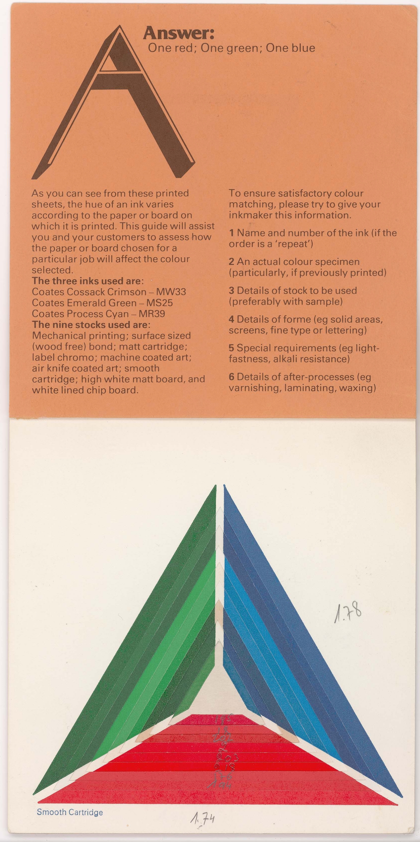

Here is a scan of another, 50-odd years old Ink Quiz, much like Gordos'.
In this quiz 3 inks were printed on 9 different paper stocks, die-cut in successively larger triangular holes, stacked and stapled together to form a small booklet.
Many times this helped me illustrate with minimal verbal explanations...
