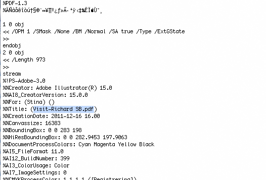

We got a enoying problem that I would love if you guys could help me get rit of.
When we RIP some PDF's from our client we get a different filename in our RIP (Fuji XMF) than the actual filename. We have located the problem to Illustrator PDFs. Now we just need to be able to remove this illustrator title so that our RIP uses the filename instead.
I'v tried to do this in Pitstop Pro 08 (we also using Pitstop Server 08) without success.
I know that theres a pitstop action that says 'remove title' but the illustrator title remains.
Im adding a screenshot were you can se the title.

What happens if you just delete that line in the same text editor? Does it then rip and image properly?
If so, then you just need a script to process all your similar files.

<snip />Im adding a screenshot were you can se the title.
The information highlighted in your screen shot is just a DSC comment in some PostScript embedded within the PDF (as data associated with a stream object). Changing the highlighted line will have no effect on your PDF file whatsoever.

Yes, when delete the title line in my text editor the RIP uses the file name.
It would be great if I could just add an action to my preflight in Pitstop Server since all our PDFs are processed there anyway. I really don't want an extra step since most of our workflows is automated.

PDF files, while ASCII coded, are considered binary files. One cannot simply whack content with a text editor without properly updating a litany of byte offset values in the cross reference table. One could pad things (out) to account for the (umm) loss of space associated with removed content but that only works when the net result of alteration is reduction of data. Growing the footprint of content *requires* updating the cross reference table.
Machines that work PDF usually insert new, potentially redundant, material to the end of a COS tree (in a PDF) and then mark the old content's reference in the cross reference table as unused (or repointed) and then add a new entry to the cross reference table to describe the location of the new element. Other changes may be required (e.g., COS object "relative" linkage) at times.

No Lukas , I want to remove the title in meta-/postscript-data. See the screenshot. No OPI involved. The PDFs are created in Illustrator. Our RIP are using the Illustrator-title instead of the filename which is a big problem in our workflow. So you could say that it is actually a RIP-problem. But a solution would be to remove the 'Illustrator title' in some efficient way in our workflow (pitstop server, XMF or similar).
