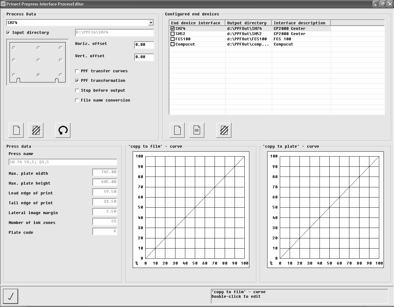

At my last shop we were running an app called "Prepress Interface", albeit a very old edition. You could define curves and apply them to the outgoing CIP3 files. You could even send to different presses independently with their own curve set..
At my last shop we were running an app called "Prepress Interface", albeit a very old edition. You could define curves and apply them to the outgoing CIP3 files. You could even send to different presses independently with tier own curve set..
Heidelberg Prepress Interface accepts the raw CIP3 files as input, the characteristic curves are applied and the Heidelberg proprietary files are output from Prepress Interface for the press. Curves are not applied to the CIP3 input files.
