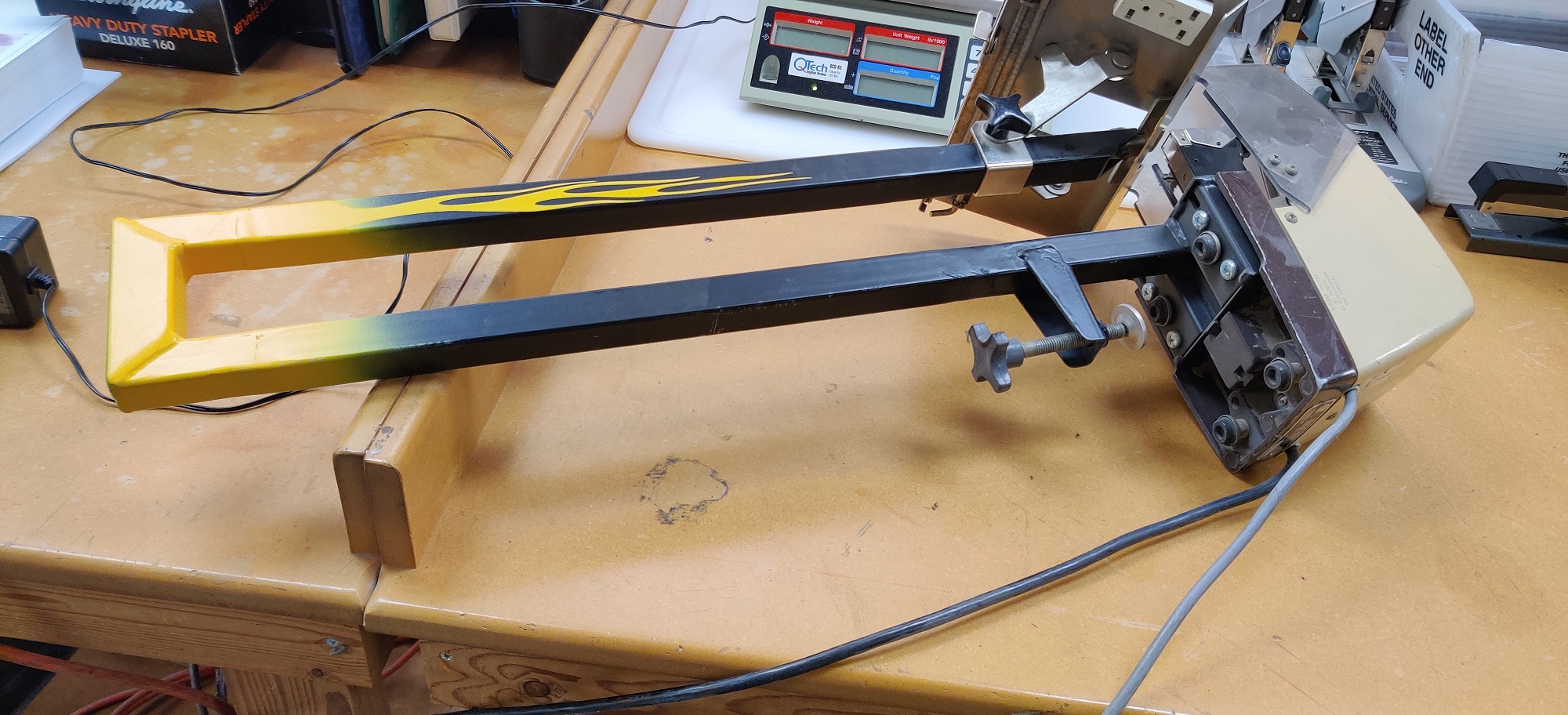

I completely forgot about that! A few years ago a co-worker took it home and welded longer pieces on for us. He even added flames as a joke since he has a vinyl cutter at home.
I have this exact stapler as well and you've just read my mind. I always thought about doing what you've showed but had no idea how to. I might show a local metal works company your picture and ask for one of these!!! ;)
