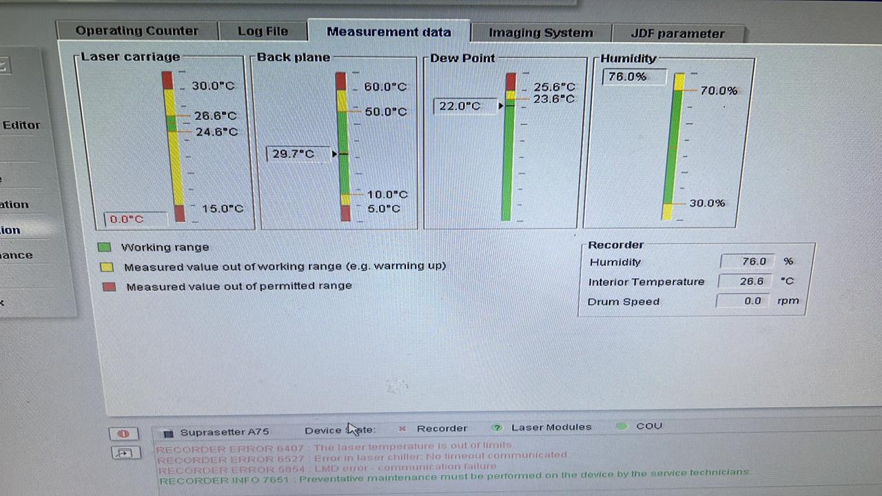

76% RH is very high and (in the UK), is above the one week moving average permitted under building regulations from a design perspective. This level will cause a whole host of problems in a production environment, both with equipment and substrates.In your case, the actual RH is 76% and the upper limit is 70%.
You need dehumidification.
Air Condition does this, but you may also need additional from a dehumidifier.
