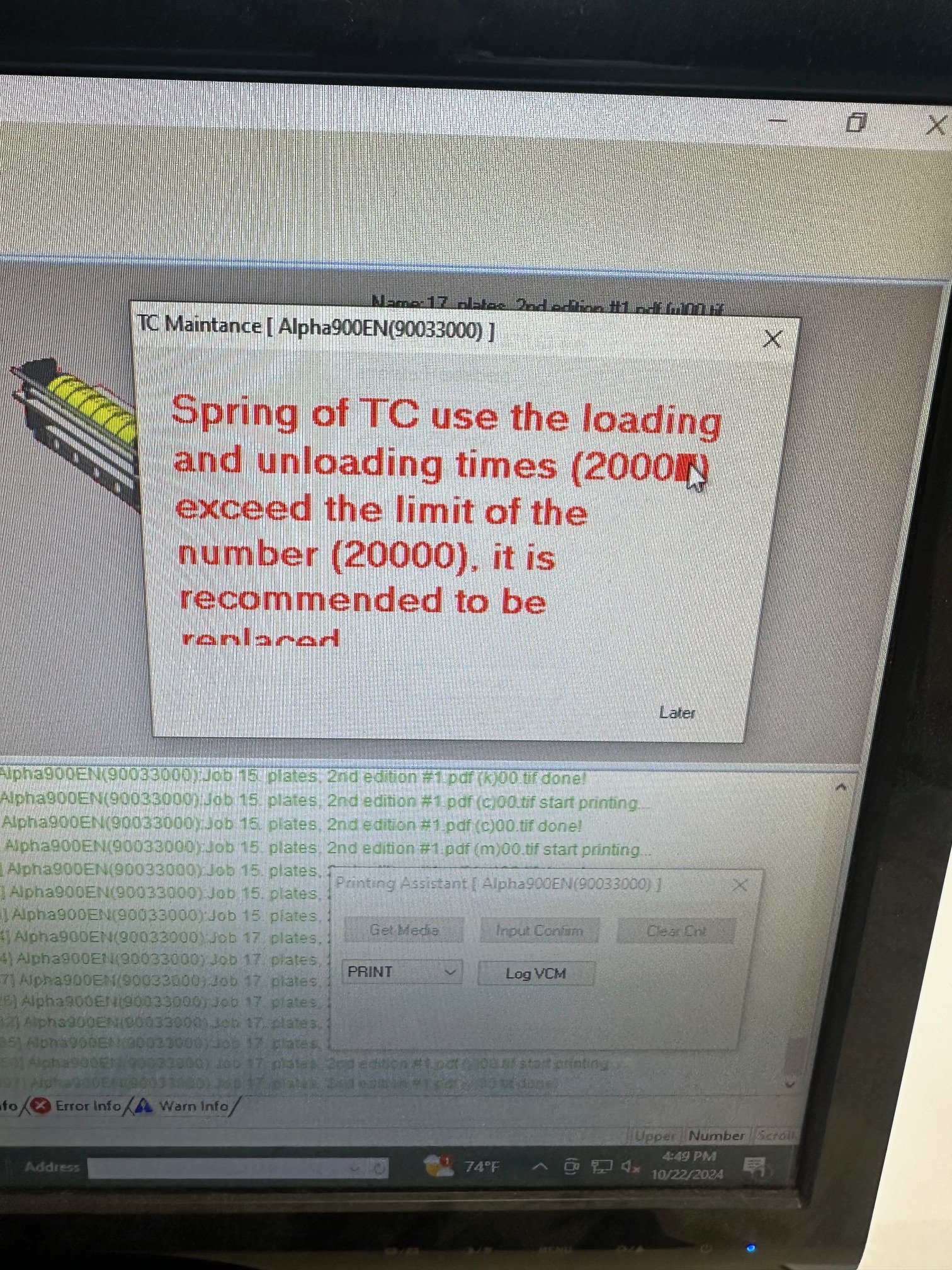

Hi Chris, I appreciate your response. We set up a Kodak Sonora plate, but my customer has other problems, like how to replace the spring of the tail clamps, he has the springs but we do not know how to replace them. If you can help me or if you can share the technical manual would be great. Thank you so much..
HC springs you just loose screws and replace them. Removing screws is not needed. Easier to do.
For TC springs is machine calling for 20000 replace?
You must have engineer dongle inserted to reset that counter. Otherwise machine will stop at 21000.
