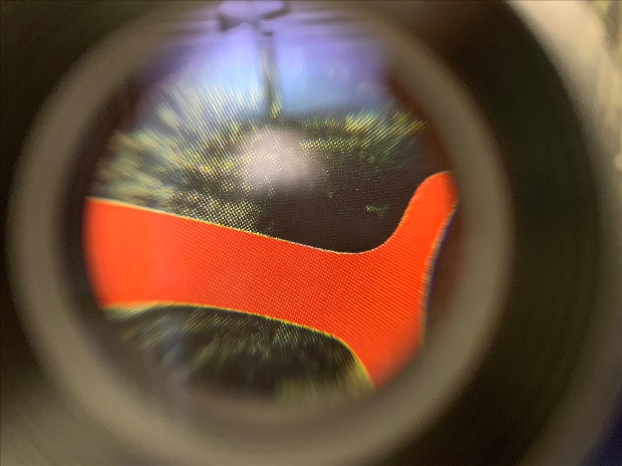

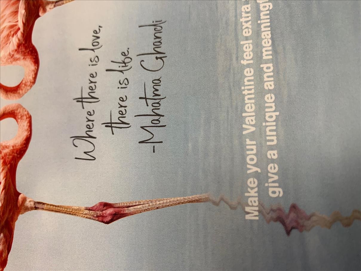

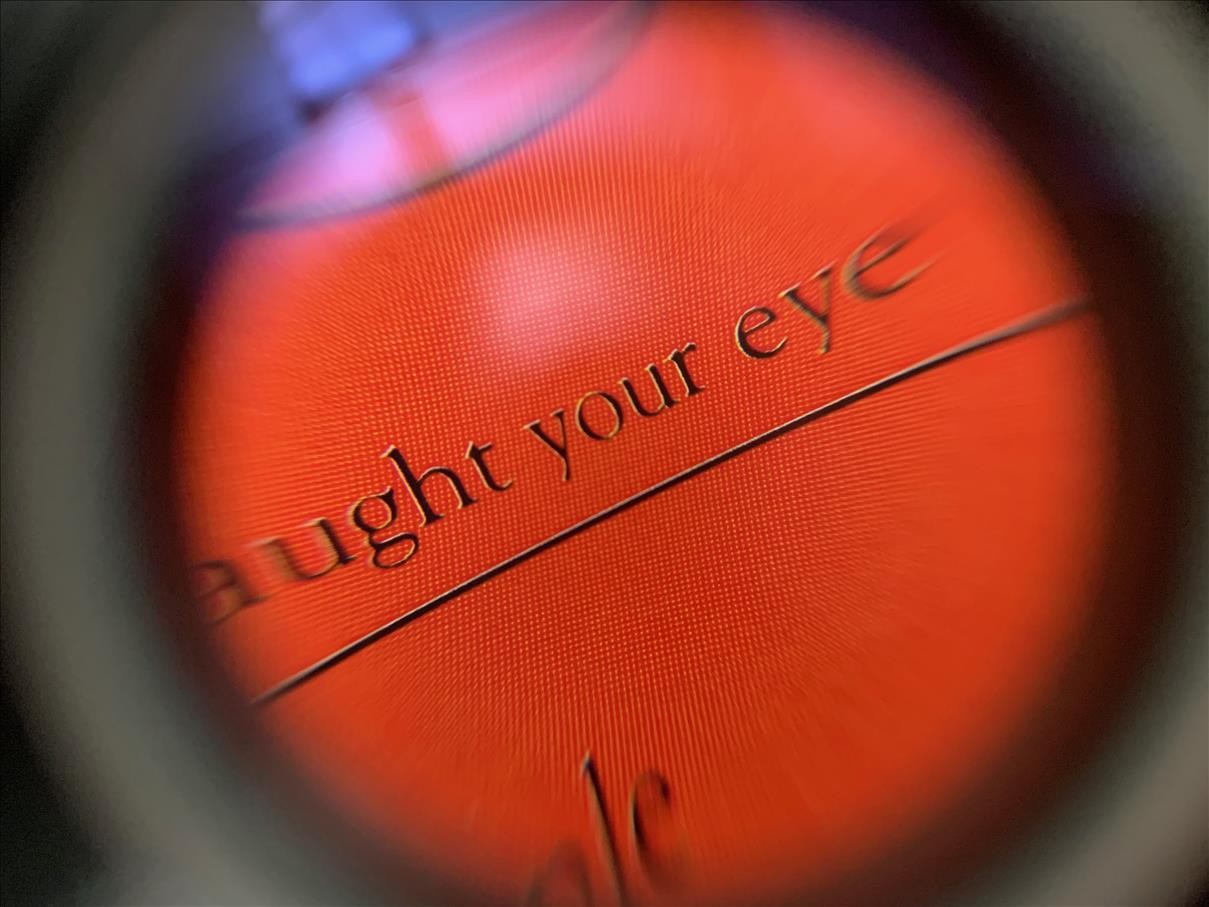

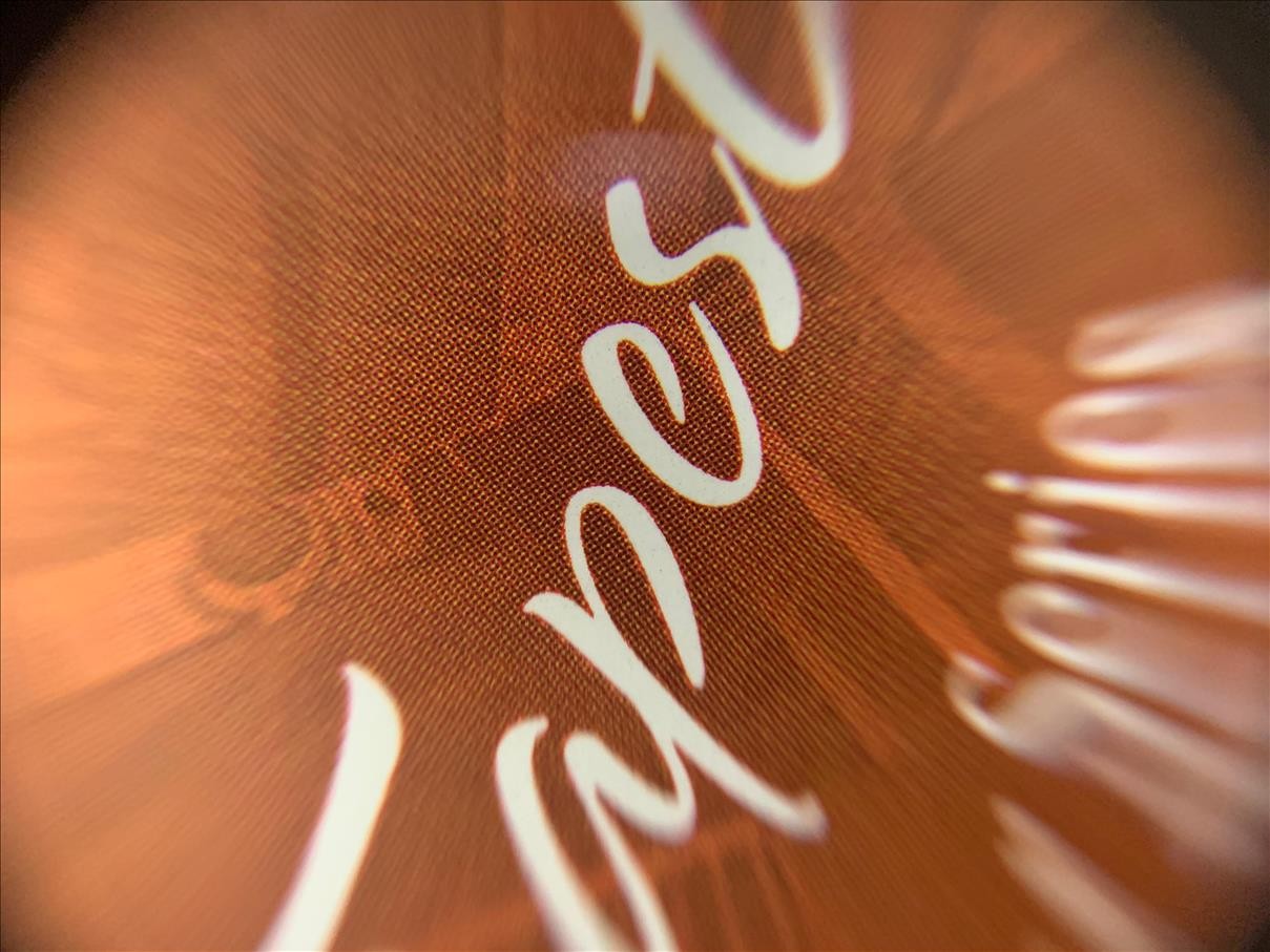

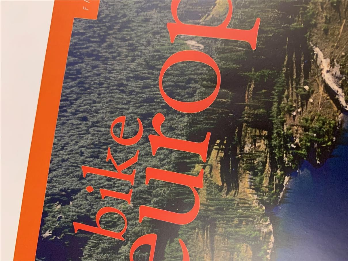

Here's some example of print issues using direct xerox provided PDFs.
The most prominent are outlines on all text no matter if the fonts are embedded or flattened in the PDF or they are generated via outlines in AI.
The other most prominent issues are just overall vibrancy of the color being laid down.
The 5th picture attached is a good example of print quality looking rough. That is on Carolina C1S, on the coated side. You can tell it's just grainy, jagged and just doesn't have the clarity or color pop as intended.

How many million impressions does this machine have? I know this is probably the first thing anyone would try, but have you enabled/disabled trapping for the PDF's? I'm not sure which options are available on an iGen 150 vs a Versant 180P or a J75, but this looks sub-J75 quality to me. Perhaps even below the quality of the Docucolor series. We all buy our digital presses on service contracts for a reason.

I agree, the imagery looks like an older docucolor, long ago we had a 700 and the quality reminds me of that.

This just looks like a lack of trap. Our iGen4 with a Fiery RIP would look just like this without it! I don't know much about free flow but I'd imagine theres an option for it.
Wippet, that's the crazy thing. What you saw, is with a trap! Freeflow you get a few trap options like the Fiery, such as outline and overprint. The trap we typically set from a .005pt to .05pt, maybe the issue is with the way the Freeflow is setup.

Yep get them in. I think it looks like a RIP issue as it doesn't look like a fit problem. I could be wrong.

That's very strange. Small black text does not need trapping - it should be set to overprint. If that is indeed a pure black text and not some very dark color.
If it is possible, can you please share the PDF of the second image you posted? I'd like to check its makeup.
