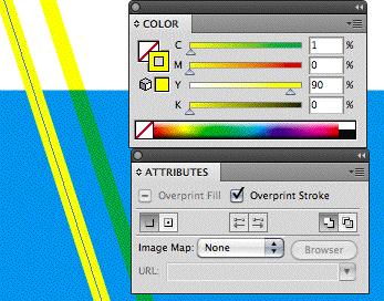

You mention printing to PDF it is not that you save to PDF? I am assuming that what you print from indesign is placed AI files? What is your PDF compatibility? Could it be that InDesign is using safe CMYK workflow (preserve numbers) and illustrator is not? Colour managing overprinted colours can give unwanted results. If you have a colour CMYK 100 0 0 0 and overprint a stroke of 0 0 100 0 the stroke will appear overprint. If the colour was managed and background is then redefined as 100 0 0 0
and stroke 1 0 100 0 the stroke will be 1 0 100 0 i e almost knocked out.
I would check the colour management and make sure colour settings are in order.
