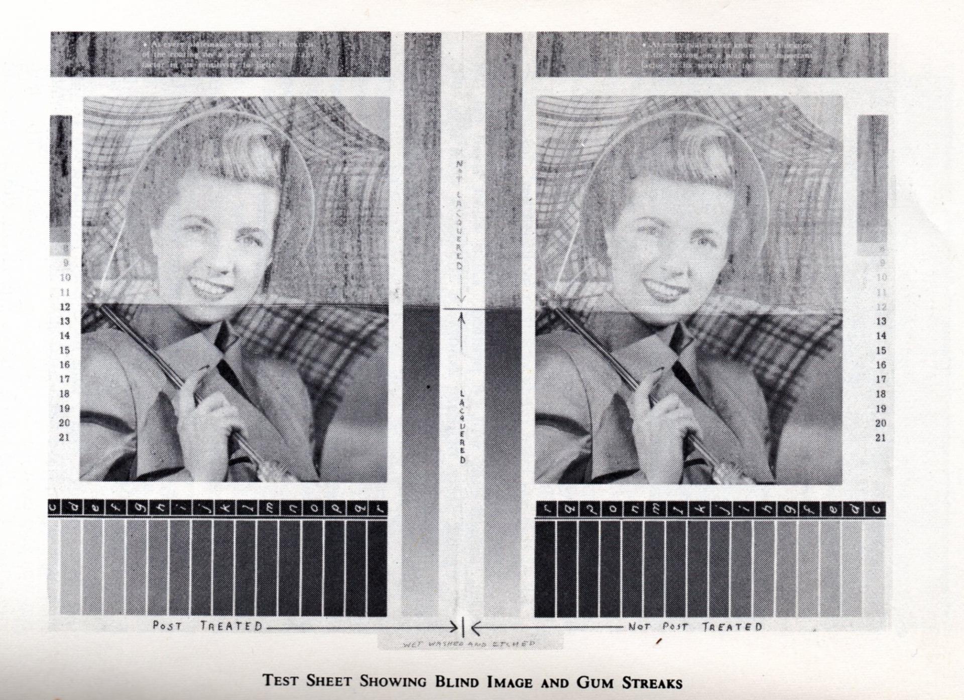

Alois Senefelder Well-known member Oct 23, 2018 #3 Hello Saravinfo10, From reading many of your posts, they all relate to a " Poor Understanding of Lithographic Platemaking" and this impacts onto poor "Press Performance" while many of the problems you encounter are....... answered by the members of this forum, you need Trained Staff !! Causes of Plate Failure: 1) Too much Ink 2) Too much Roller Pressure 3) Too much Impression Pressure 4) Too High a Blanket 5) Fountain Chemistry and poor Plate Making Techniques ! Plate Failure: 1) Scumming 2) Plate Blinding Also post Photos of the Plate Problem !! Regards, Alois Attachments Test Sheet showing Blind and Gum Streaks 1034.jpg 508.6 KB · Views: 584 Last edited: Oct 23, 2018
