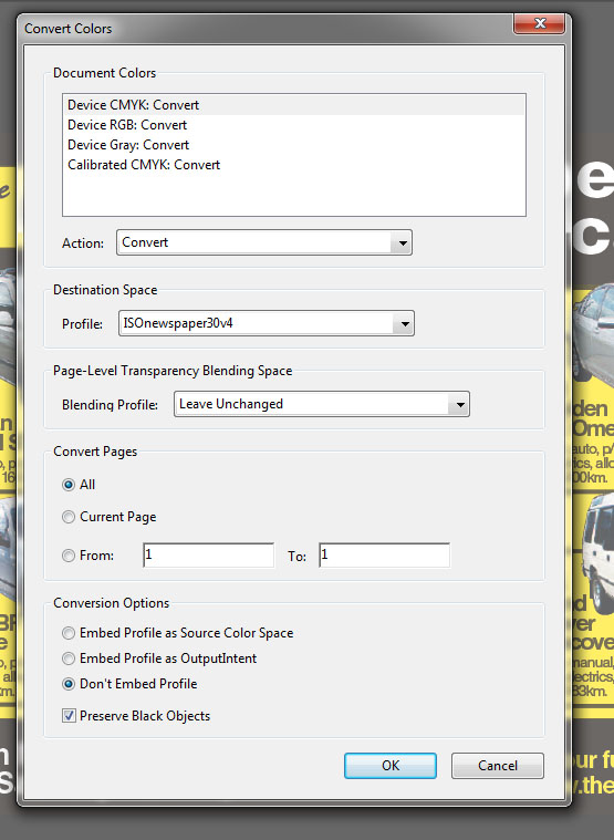

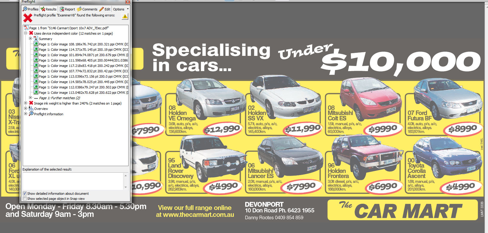

We have an agency who supplies our Newspaper with complete PDF's for their client. Since they have upgraded from CS3 to CS5.5, our preflight picks up Independent Colour (Examiner Preflight Results.jpg) in their images. If this isn't corrected (I use Acrobat 8 Convert Colours, see Convert Colours Fix.jpg), Prinergy Evo strips out of the colours, leaving them very pale and an unhappy Ad Manager.
Can anyone let me know if it is something their end with the way pics are saved in Photoshop CS5.5 or anything in the attached settings.

I have not had a great deal of time to look into this, however:
* What are the exact PDF export settings out of InDesign? Would using PDF/X 1a help (simply supply untagged/deviceCMYK)?
* If not exporting via X1a, would turning off profile embedding help (simply supply untagged/deviceCMYK)?
* What are the Prinergy Evo settings in regards to images with embedded CMYK profiles?

Just curious - is the ad manager complaining about the color onscreen or proofs and printouts? From what I can see, the file seems ok. I agree with Stephen's comments about adopting PDF/X-1a as a standard file format or looking at the GWG.
You mentioned Prinergy strips out color profiles and in your Acrobat conversion settings, you're not embedding profiles. I'd also double-check how Prinergy is handling tagged images.

Try this file, I have removed the ICC Tag in the images.
That is what I was pointing out - an untagged image does not trigger this preflight error. That being said, I am not sure how Prinergy Evo is setup, it sounds like it does something weird if there is a tagged image...

Thanks Stephen. The designer at the agency has done the same at their end and selected Don't Include Profiles from ID.
What I can't work out is why this started with their upgrade to 5.5?
