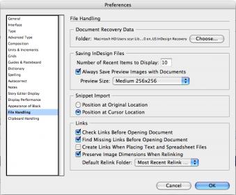

You have to go in Preferences/File Handling and make sure to check "Check Links Before Opening Document"

Hey Color
I double checked my settings and I have the same, I'm pretty sure that is default for the apps. CS4 has the option but CS3 does not. What happens when I open a file in either CS3-4 is the file opens without displaying the auto update link dialogue. I just see the file open and the link palette displaying the yellow triangle with missing links.

When all else fails go into your library and delete the apps preferences. It should be in Users>Library>Preferences>Adobe InDesign> Version 5.0
