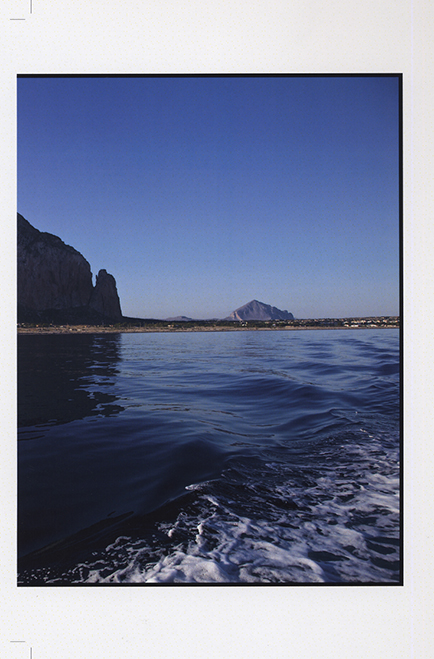

KM C8000 color gradient

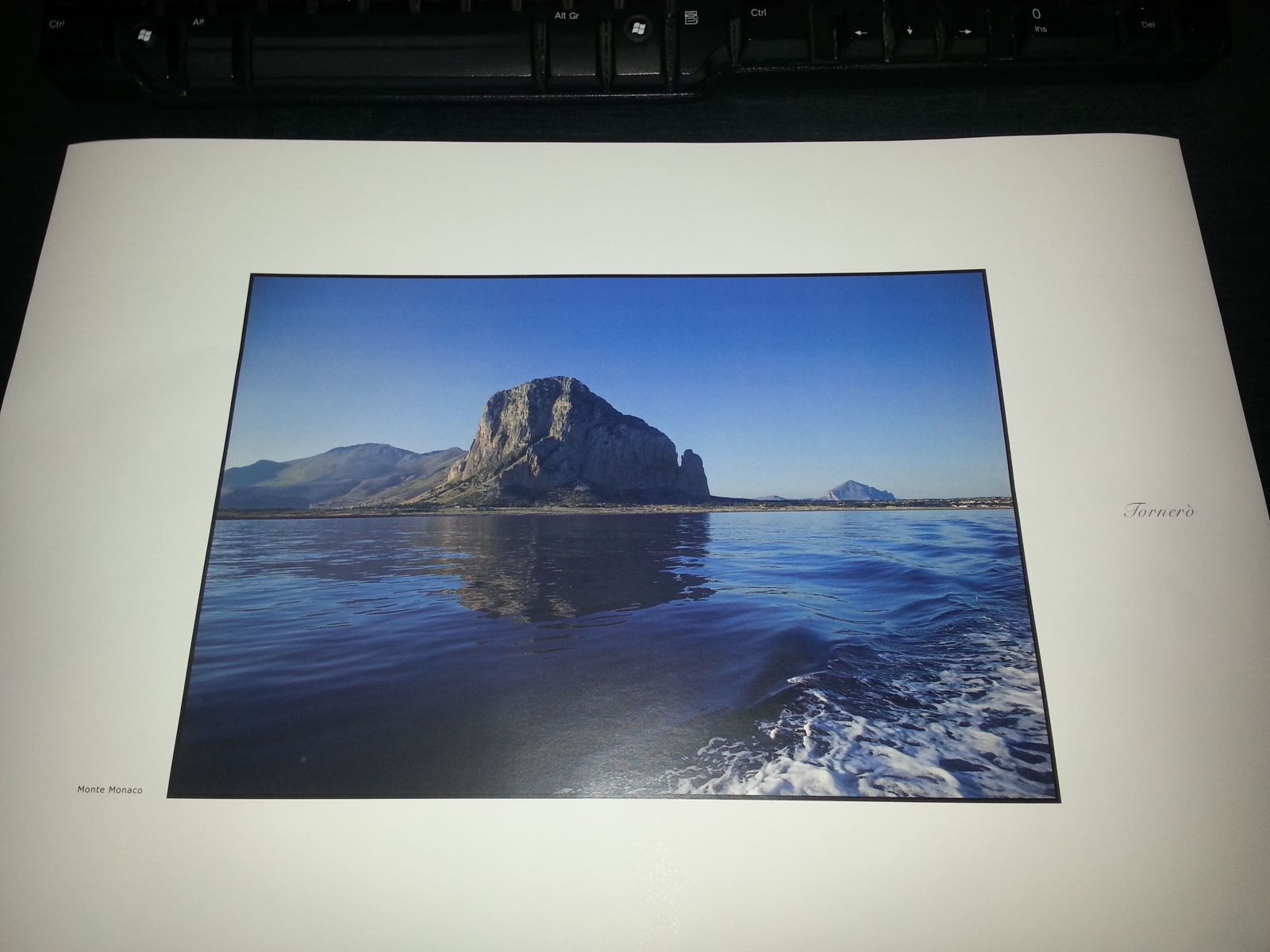

Ok, So its really an issue with either your RIP or your C8000. Mine printed real fine. (see attached scan)
Sorry i cant help you more.

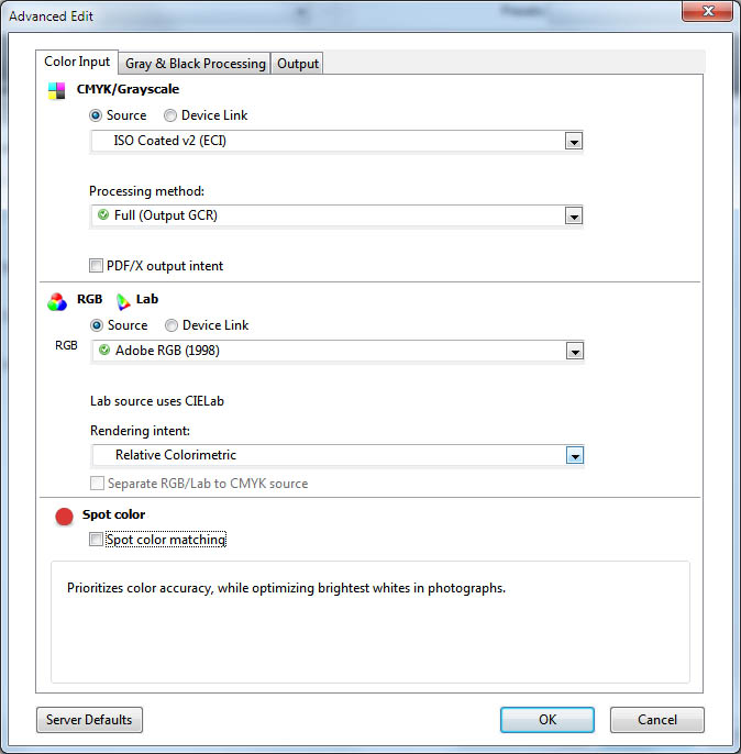

Have you tried turning grey processing off? I once had that problem on our C8000 - I ended up using another colour press that ran on Creo which worked, but I've since learned that this sometimes does the trick.
I used your settings, but doesn't work.

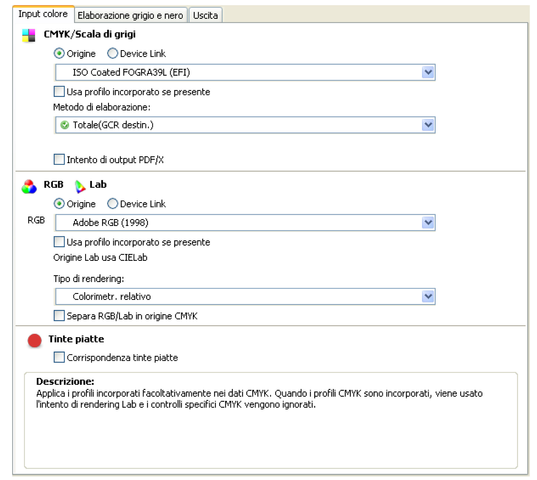

I have output the file on our C8000/Fiery both by printing to the hold queue and using the standard Fiery RIP and also by dropping the file into hold and using the APPE option. Whichever I choose, the output is good. Our Fiery is v9r2 and the engine has the latest firmware (upgraded yesterday, by coincidence). The annoying thing is that I am sure I have seen an effect like this before (on a C6500) but can't recall what caused it.
Our colour settings are much the same as yours except the grey & black processing is set to "Text/graphics". We have had unexpected results if it is left set to "Text/graphics/images". Are the settings on your "Image" tab all set to the defaults?
I try all settings about image, with poor result, it seems that a specific range of cyan gradient is not interpreted correctly.
Change profile moves the problem inside the picture.

I tried all options about color image.

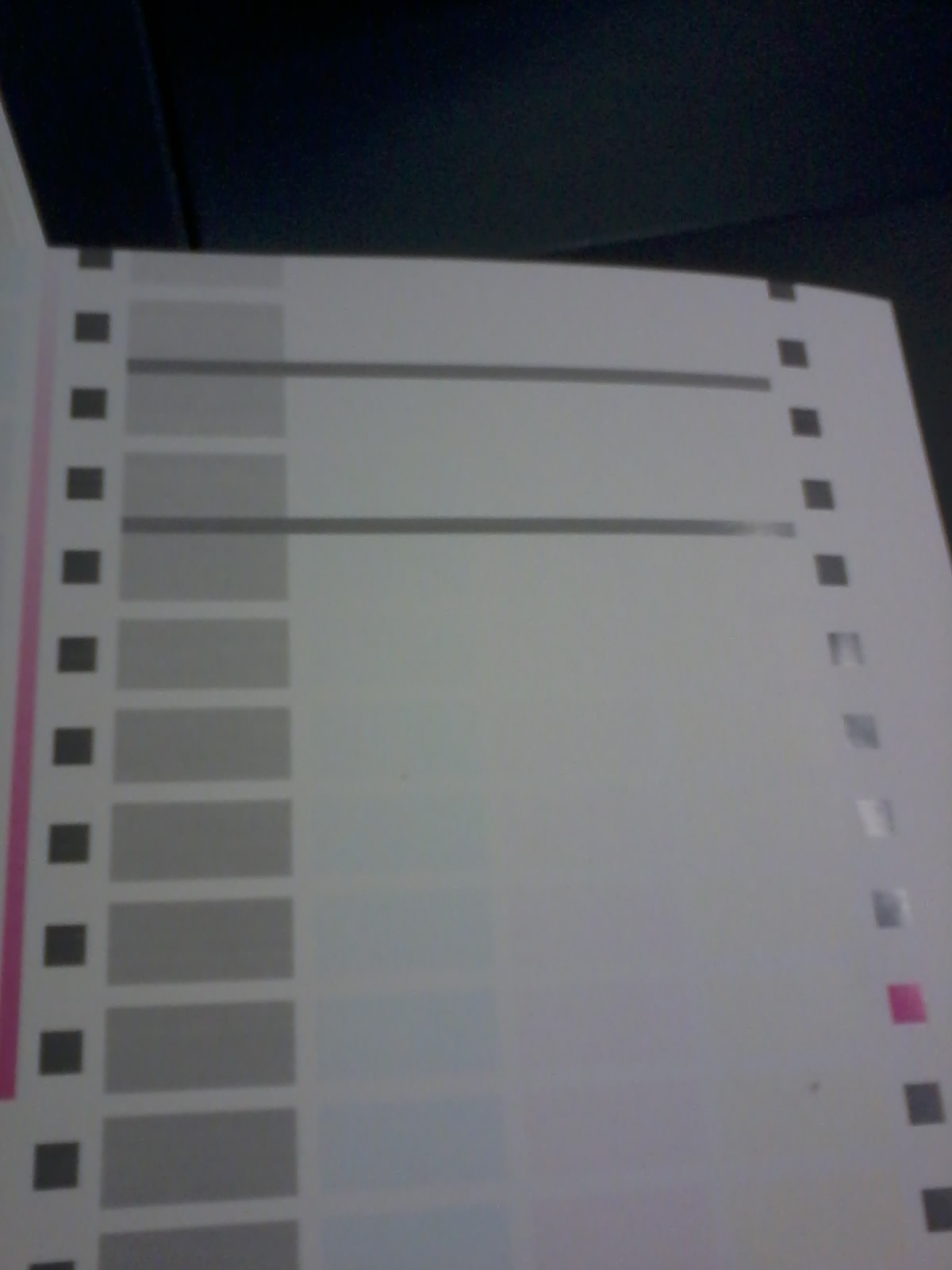

I have a similar issue, but only happens on A3 gloss paper...
and it runs on one side of the sheet along the 297cm side.
Technicians baffled, well i dont really blame them, as in our region we have the only C8000....
I think there are only six in South Africa....
I dont think there are even any Ricoh or xerox equivalent machines around us...
