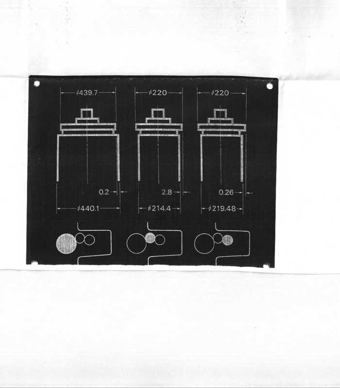

I 100% agree with you on both the roller settings and the cylinder packing. On this particular press Komori wants me to pack the plate to .006 over and the blanket to .002 under. They were adamant about it. After several months of fighting picture framing problems I finally said the hell with it. I ran a virtually identical press for 10 years before this one with no picture framing problems whatsoever. I have been trying to figure out what they have changed. The cylinder packing is one. I am now packed like my former press.
Plate= +0.00233
Blanket= + 0.0025
I have borrowed a packing gauge from a friend to make sure mine is reading correctly and they both read the same.
I sure print a lot bettor this way especially with lightweight uncoated stock. All I have to do is add .004 to my calibration of stock thickness to start because they have also changed the size of the impression cylinder and the transfer cylinder.
Komori demonstrator was in a few weeks ago and finally agreed with me that this packing set up is bettor.

John, Thanks for the illustration. Whenever the cylinders are the same diameter, it is important to have the plate and blanket diameters the same so they will travel at the same speed (meaning pack each to the same height relative to the bearers). I am convinced that most Komori sheetfed presses that picture frame are packed in a manner that increases the friction between these two surfaces. I have seen similar problems on Planetta presses that are without bearers, where there was no reference point to work from and the packing recommendation was causing plate wear and other issues. This simple speed difference problem is also the major cause of plate tail cracking on webs, but for some reason it never seems to go away.
