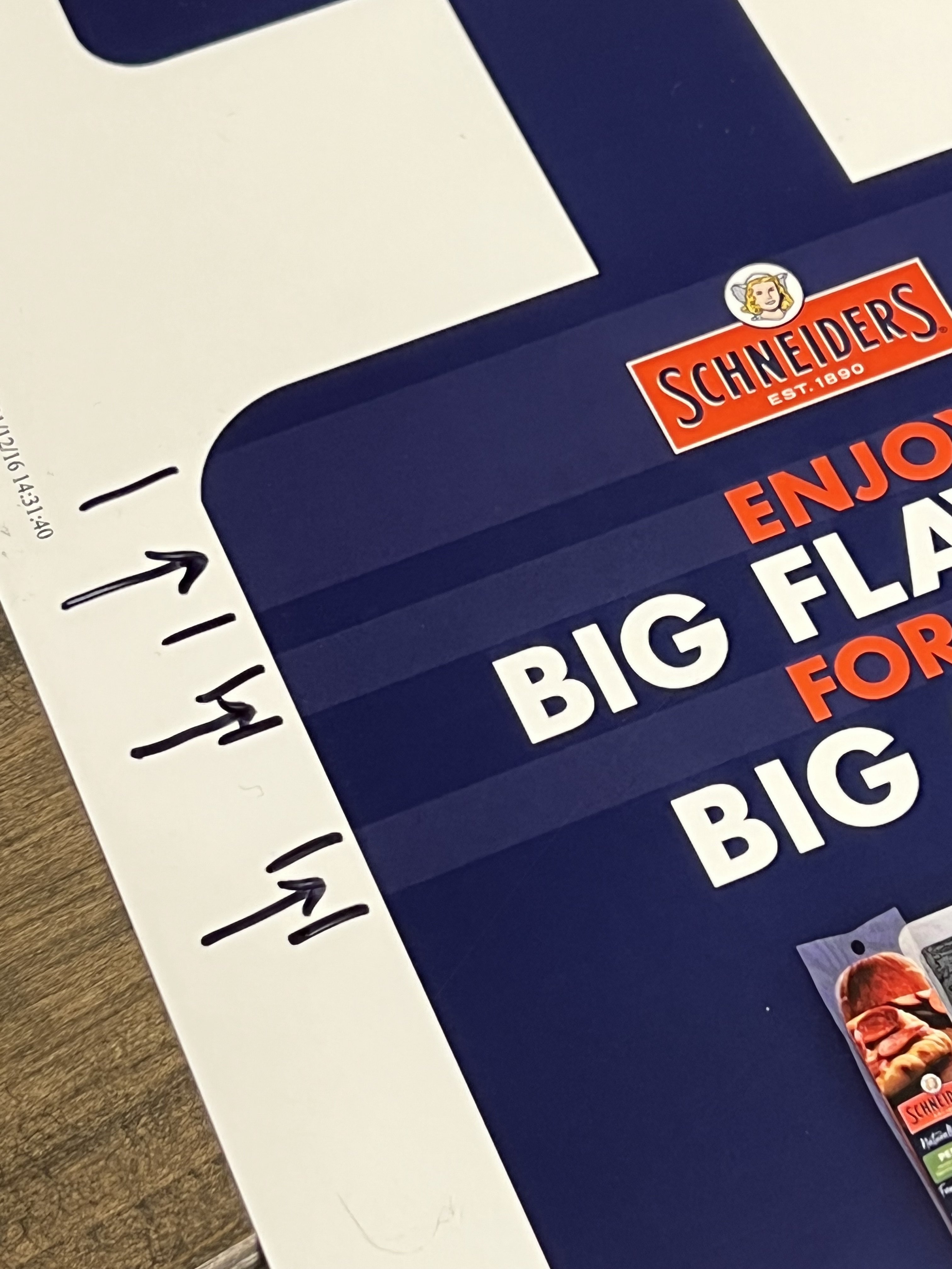

Once we impose using the Fiery software, the image has broad bands of subdued colour.... graphics still all print, just broad bands of lighter colour randomly through the graphics. At whits end here.

Hi jwheeler, pic and file attached. I appreciate you engagement here...

Looks like a RIP setting issue.
Do you have the RIP package with Imageviewer? If so you should be able to see it.
Most likely an overprint issue. Try with and without APPE and the Composite Overprint setting.
Also check file in Acrobat with Output Preview, Simulate Overprint checked and unchecked.
Thanks DYP... so far some success with a 'ftattening setting' after layout... apparently after imposing you can 'flatten' the sheet to an 'IMP' file, or leave unflattened as a 'DBP' file format... the DBP format seems to fix the issue with APPE check on. I will see if the translates across all the jobs going forward however.
OK, 3 tools to fix rendering issues from within the Fiery job properties - after Fiery impose, use unflattened (DBP), also deselect 'PDFx rendering intent' and deselect 'Composite overprint'.
