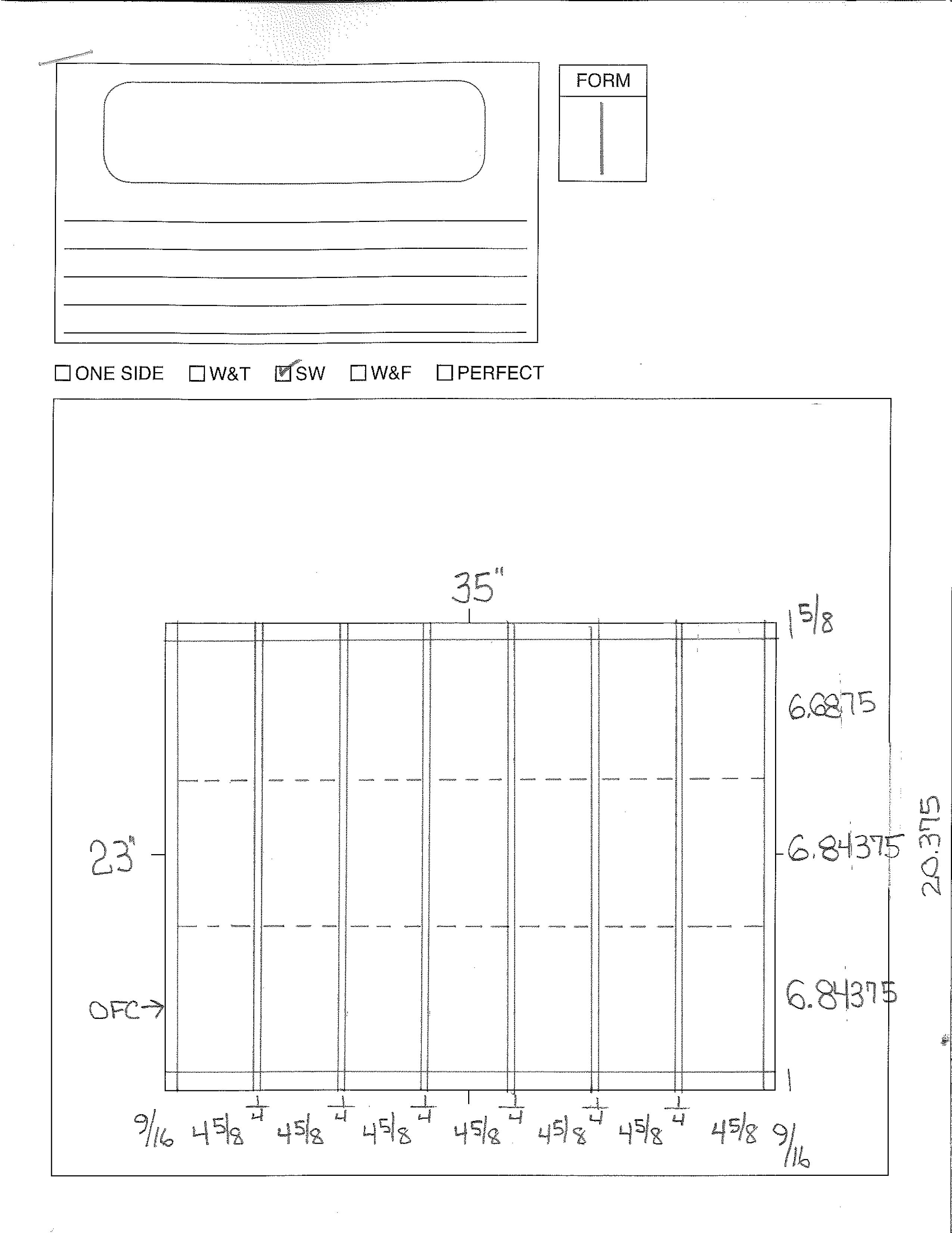

I guess I am still not explaining well enough about what I am asking so again, I apologize for any confusion. What I am asking is NOT about how someone actually imposes a job using whatever software they have. My question is about how a job planner (or similar position) shows a prepress person HOW a job is to be imposed using whatever software they have.
Attached is an example of a layout. As you can see, it was mostly drawn by hand. What if an app could generate the attached sample layout (drawn electronically of course) for you with just a few pieces of information (such as sheet size, trim size, head direction, gutters, margins, etc.)? If such an app existed, what sorts of features would you want to see in it?
Hopefully, this clears things up :)
pd

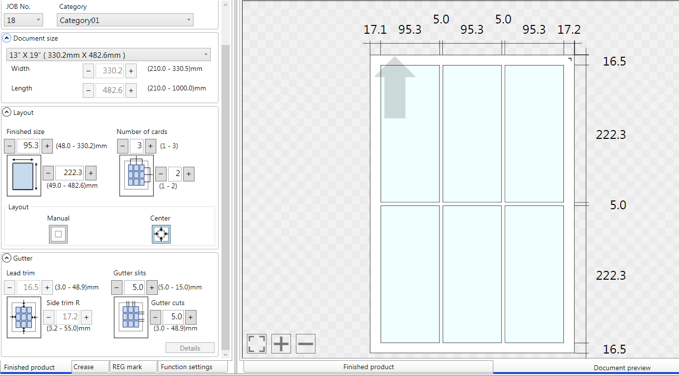

I was a bit confused but this makes it clear. Your sketch looks just like the document preview in the Duplo job creator. Overall document size is missing from the Duplo preview.
