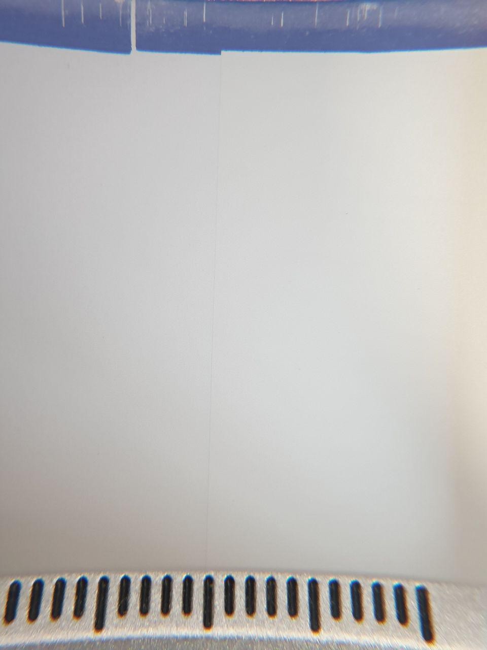

in our prepress department when plate comes out from processor there is a line right at the intersection of left and middle lasers its very thin but shows after job printed
our machine is suprasetter 105 with 3 laser heads
we change the developer and major clean processor
every things was good but after 2 days the line appears again
i contact Heidelberg agant and he said: raise laser power of left head to 100
its now set on 88 and im afraid of raise of laser power Cause a lot of pressure on laser head
I'm glad to hear your comments...

I did not understand how a Heidelberg staff suggested this solution. The start point parameter of the laser head(s) which is located right side of the line, should be increased 1 step. Heidelberg service can do this with remote connection.

i thought about Aligning of point parameters too but beside of the line the left side is little darker than middle and right side of the plate
