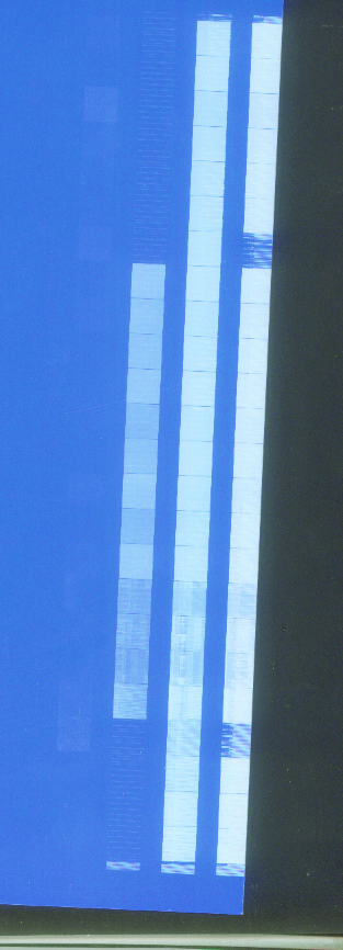

Did ex curve and focus test same status;; no image
pls find attached image when we reduced the drum speed ; intensity and focus test..
drum speed 750 - 900 ; intensity 366mw ; focus 300 -450
regards
kalaView attachment 3368View attachment 3369

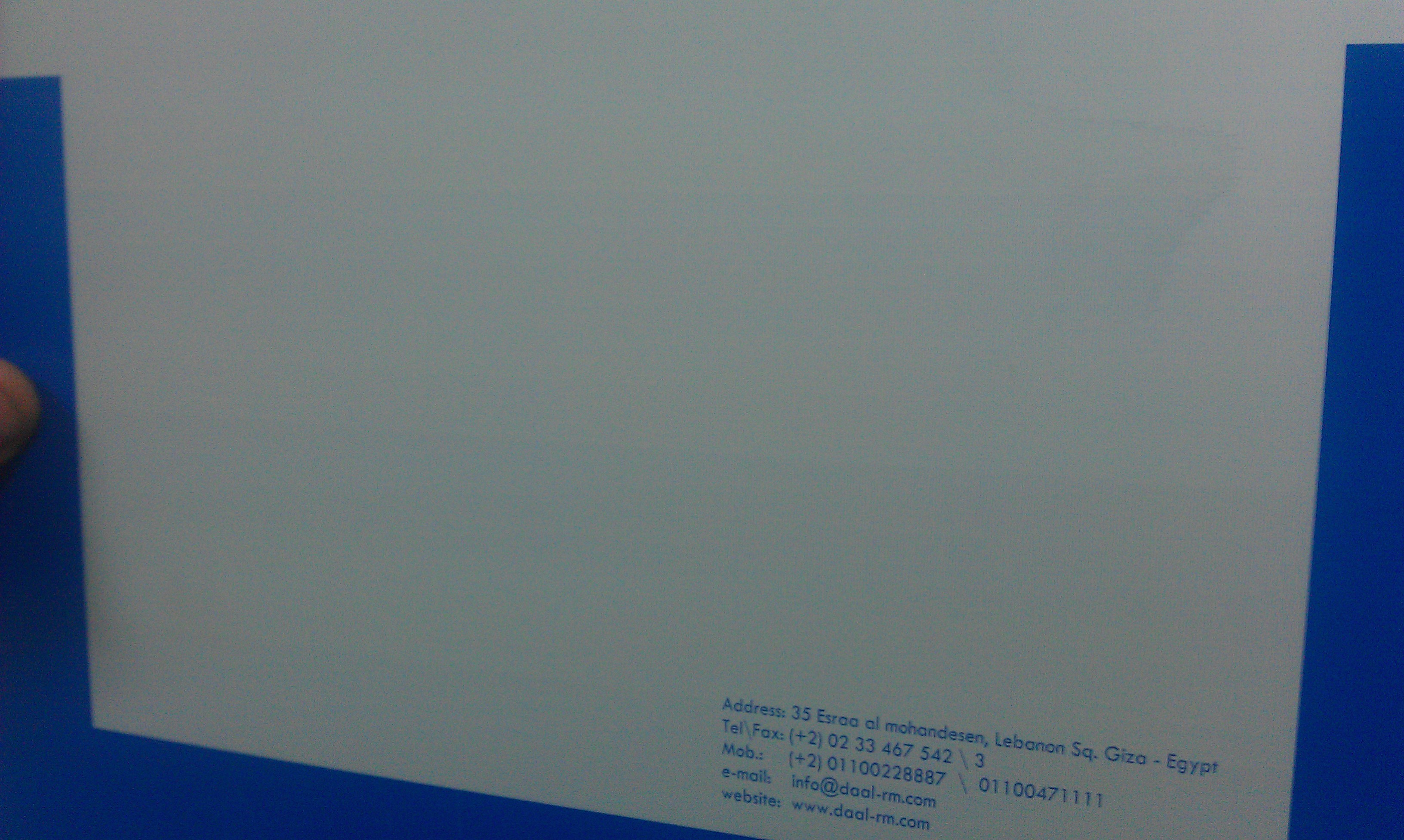

i was having the same problem today, tried to change DDB but still exist .. so i tried to change that little board above the DDB and it's worked just fine like before , can i ask for the name of that little bord i've changed ???
The name of the board is TEC and the P/N is 503C2L738S for 24 Beams and 503C2L033S for 48 Beams.
thanx alot PACH for ur fast replay
but please see the pic i attached for the Laser test , i experince a weired lines vertically all over the plate ,
sorry for the low quality but i hope u get wt i mean ,,
p.s : i changed the DDB+TEC boards after having no exposure at all .. then i start getting exposer with these lines all over the plate , please advice if there any thing i can do at all here !
