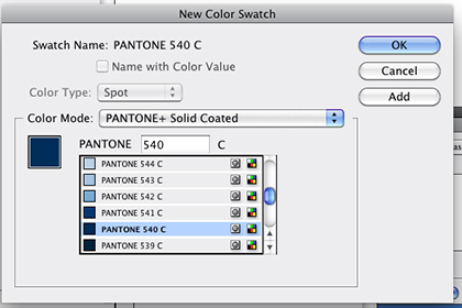

So we've come across a new one... now that CS6 uses Pantone+ rather than Pantone, we've noticed a few colors missing from the library entirely. We went to create a file using Pantone 540C and found it to be missing. Any idea if this is a glitch or how it can be explained? Our understanding was that Pantone+ libraries added colours but legacy colours remained.
Just like PANTONE messed with a good thing and "re-organized" the sequence of colors in their PANTONE+ swatch books, they did the same with their digital swatch books.
540 (and all the other colors) are there, you just have to scroll to find them. The "find" field doesn't work that well.
Oh hey! Look at that. Well that makes perfect sense. Maybe a bug fix is in the works? I mean, out of order is one thing but is the search function can't find it???
Thanks for the heads up.
I think we're dreaming if we expect them to "fix" it. We're stuck with what Adobe and Pantone decide to give us.
