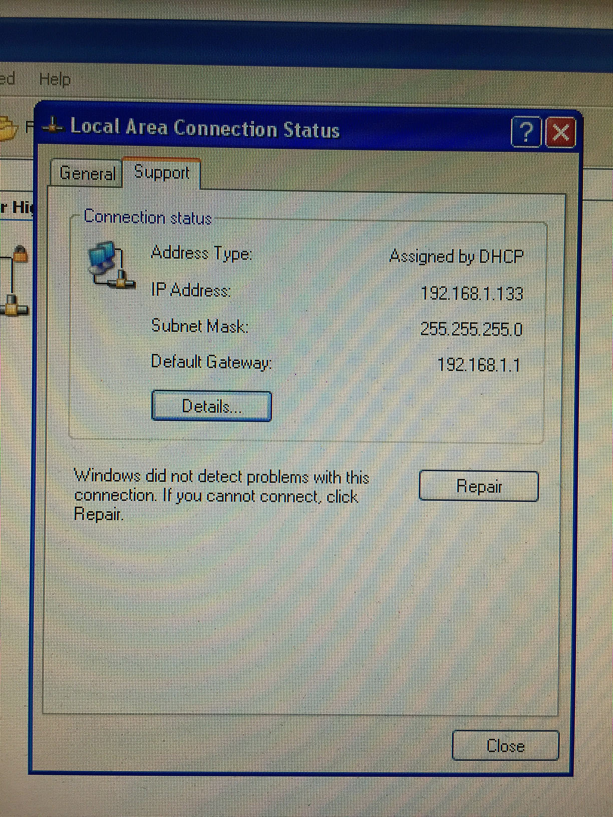

Sub-Net settings are crucial. Print the display from the PC and make sure the Mac can reach it and SHOULD be on the same subnet.

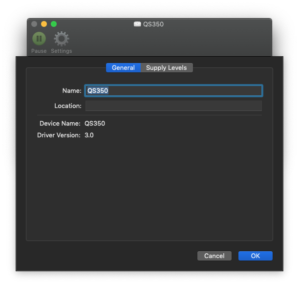

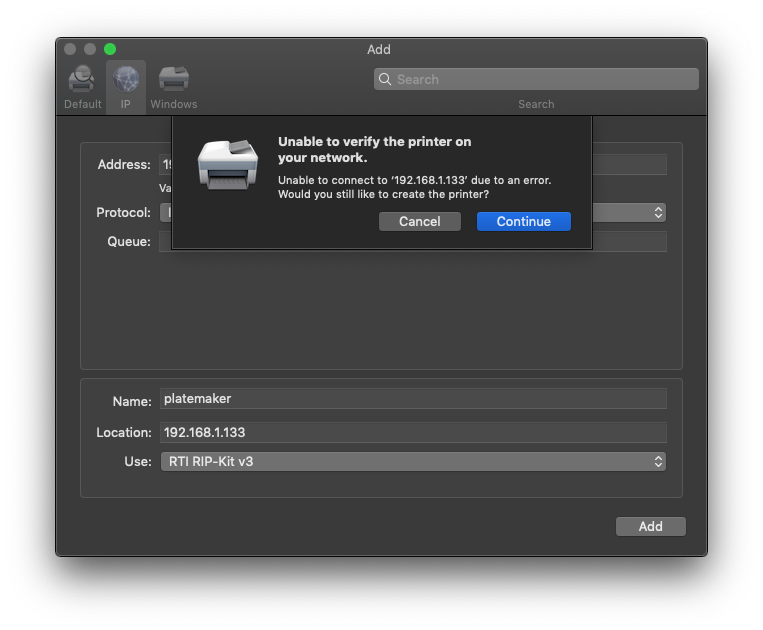

Sorry, I don't really follow (barely understand windows). On the PC, go to control panel and then what? Here is one screen. I'm using this IP in the iMac connection, but it won't work. SubNet mask is the same on the iMac. Also, here's my actual printer QS350, but it doesn't give me any details. The PC is never touched, except to release plates. This would have to be on the Mac end.

The Quicksetter printer may require Netbios
NetBIOS is disabled in macOS 10.15 to speed up mounting, browsing, and connecting to SMB shares. Some older printers and file servers may require NetBIOS to connect.
To enable NetBIOS, you can create or edit the /etc/nsmb.conf file. If your system doesn't already have an /etc/nsmb.conf file, use the following Terminal commands while logged in as an Administrator:
echo "[default]" | sudo tee -a /etc/nsmb.conf
echo "port445=both" | sudo tee -a /etc/nsmb.conf
To disable NetBIOS, you can safely delete the /etc/nsmb.conf file.

Firstly you are using DHCP on the PC which means the IP address can change on a whim.
You can't (shouldn't) use the IP address to connect to the printer - if you do this it is prone to 'breakage'.

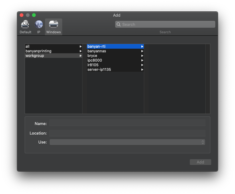

So you should be using the next tab in the Mac window 'Windows' to find the printer.
Do you 'see' the printer there? If not the network settings on the Mac need to change.
Also you have to have the name and password for a 'user' on the windows machine.

“So you should be using the next tab in the Mac window 'Windows' to find the printer.”
Tried. Even my machine doesn’t see it.
