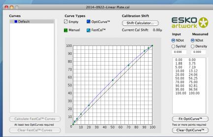

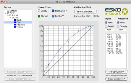

Yes a snapshot of your curve file. we run with 3 different lpi screens and each will run with different values you will not need to do all of that. just 1 will work for the 2 color Ryobi.The photo on the right may work as a test setup.

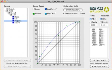

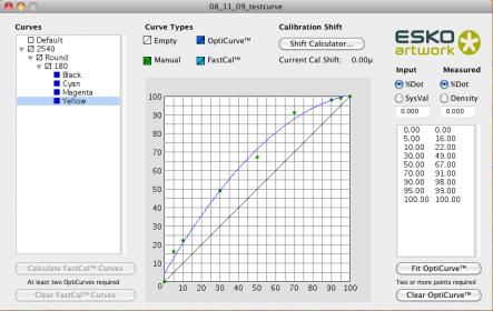

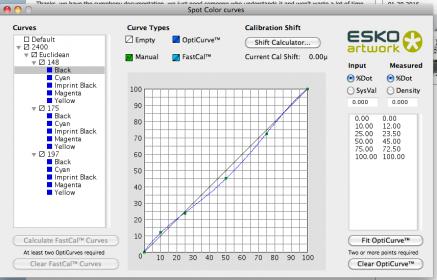

Here are my curves, I think they are jacked up. They shouldn't all be identical....right? Screen Shot 2016-02-05 at 8.24.22 AM.png.jpg
The curves were done before I came onboard and I've never been trained on Nexus software other than how to use it to make plate files and send to rip, I don't know how to set it up. I've got the symphony reference guide and I found a document that shows how to make curves for a wide format proofer, but I don't see a document that shows the steps to make the curves for a press. I'm pretty sure i can enter the data into symphony to create the curves, but what do I print on the press to get the numbers to put into symphony?

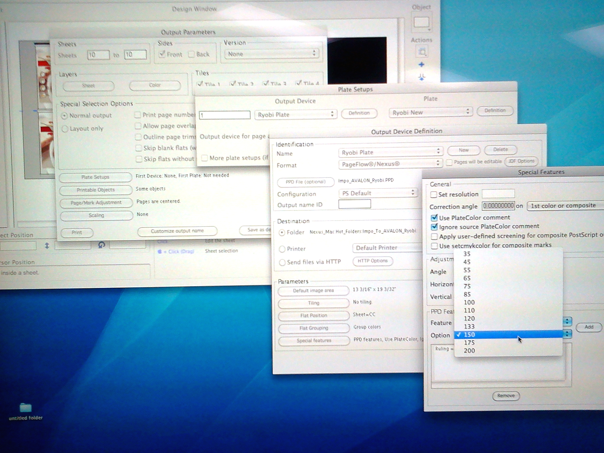

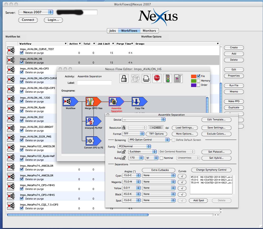

Your Ryobi may run much better and cleaner with 133lpi to 150lpi if the press is old and needs new rollers. With luck your rollers are in great condition so you can run 150lpi to 175lpi. The screening part open your (Nexus) go to the (Work Flows module) you have for the Ryobi open the (Assemble Separation) look at the (screen family) we used (pcc nominal) unlock this then unlock (Dot) we used (Euclideaw) and unlock (Rulling). and save Now when you open your output pagination program we used DynaStrip. you should have a pull down menu for your plates you can decide on the best lpi at that time. This works for us depending on the stock.

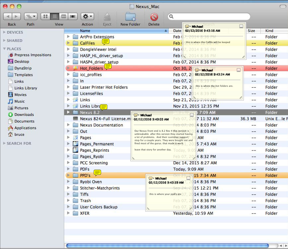

And I am working on the cal files. photo photo 1 our output DynaStrip Photo 2 Nexus Assemble Separation photo 3 nexus folder.
