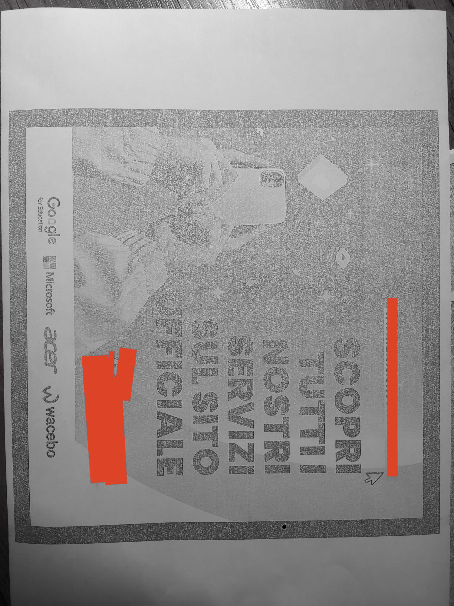

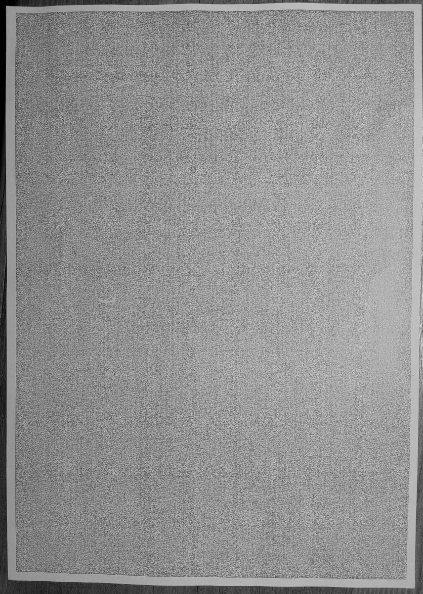

I have this problem both on Black Only (K) printing and on CMYK color printing.
The colors come out Light, the toner is not dense. (The attached photos are of Black and White printing, but if I print in color the result is the same with the 4 colors, washed out image.
This happened after having Disassembled, cleaned and reassembled the "Black Only" Drum Cleaning Blade (transfer belt).
Assuming that it damaged the Black Drum, I can't understand why the problem occurs on all 4 colors.
Everything was fine before this operation. I only disassembled the blade, cleaned it and reassembled it, I didn't touch anything else nor removed the toner or other rollers. I can't find any solutions, please help me.
