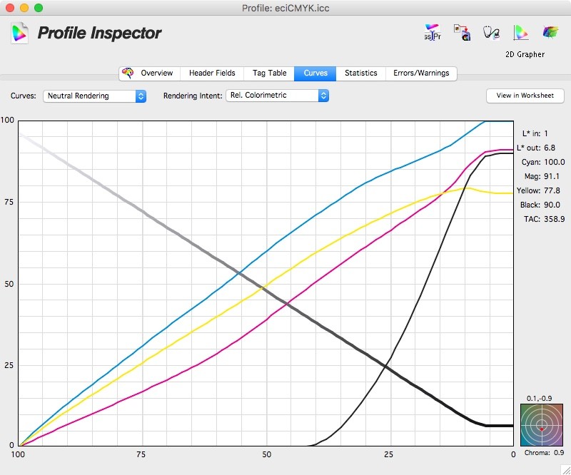

Interesting that it's not just the Fogra 53 profile that they will supply, but also 'Device link profiles for conversion from and into established Fogra standards will be available shortly.'
Could be interesting to make some for US standards as well.
Of course it's an M1 profile inline with the latest Fogra standards, made with Heidelberg PrintOpen it seems.
# Printopen - Profile parameter setup #
CMYK_PROFILE: "Y"
TOTAL_DOT: "400"
MAX_BLACK: "90"
BLACK_LENGTH: "69"
BLACK_WIDTH: "3"
PRESERVE_COLORS: "0"
SATURATION_DARKER_LIGHTER: "0"
CONTRAST_DARKS: "N"
COLOR_SATURATION: "0"
GLOBAL_DARKER_LIGHTER: "0"
GRAYAXIS_CORR: "N"
AXIS_CORRECTION: "5"
AUTO_MEASCORR: "N"
# Proof setting: #
CONS_BRIGHTENERS: "N"
LIGHTNESS_ADAPT: "N"
PAPERWHITE_LVAL: "0.0"
Curve from Colorthink attached
