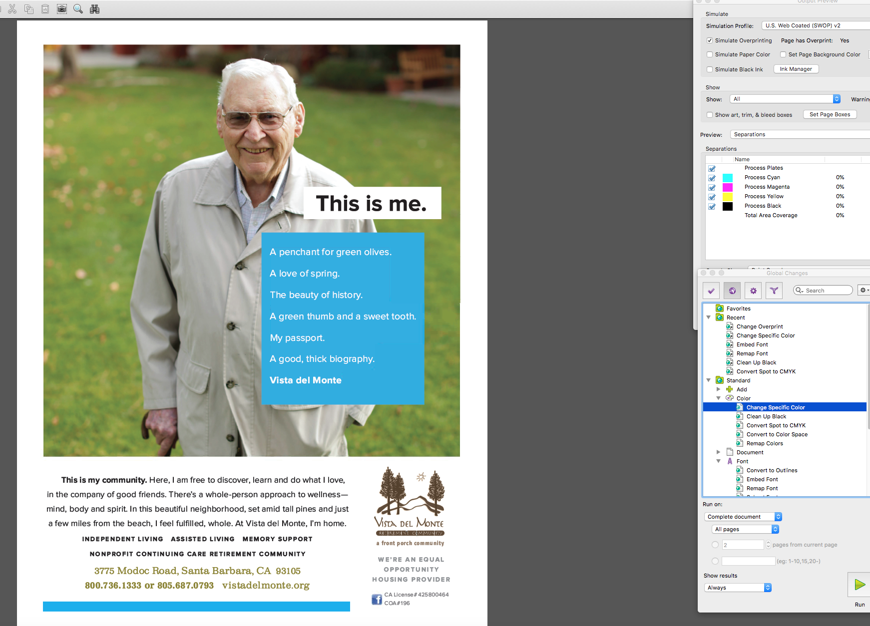

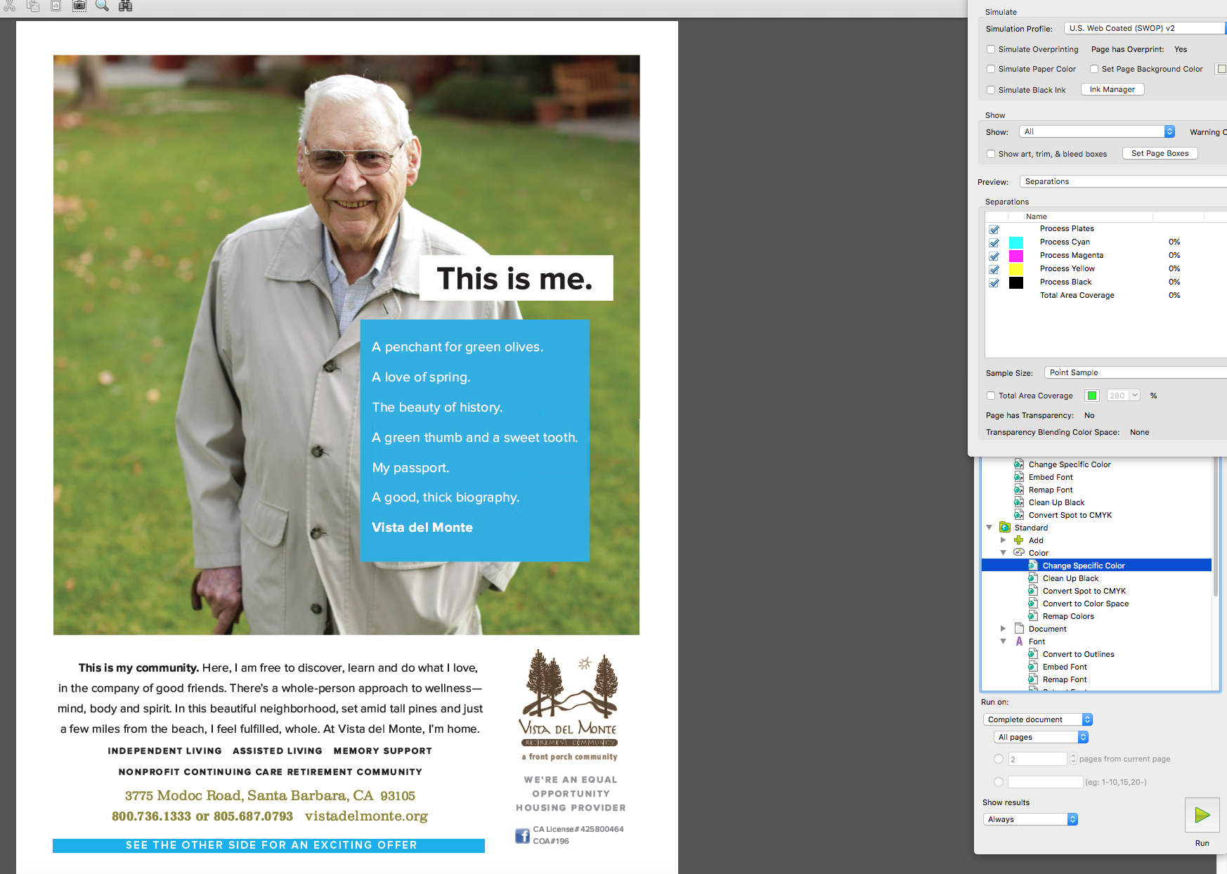

Appreciate the help guys...So this has happened to us maybe 6-8 times we have had to reprint the job, basically trying to find out if its something that we are doing or something in the original artwork that is causing the problem. I have attached 2 files here, one shows the blue bar at the bottom with the type as its supposed to read (with print production/output preview/Simulate Overprint clicked off) and one with the type missing with simulate overprint clicked on (which is our default view) I also would assume that something in the PDF export from indesign would have something to do with it because the customers original views fine with both simulate overprint setting on and off.

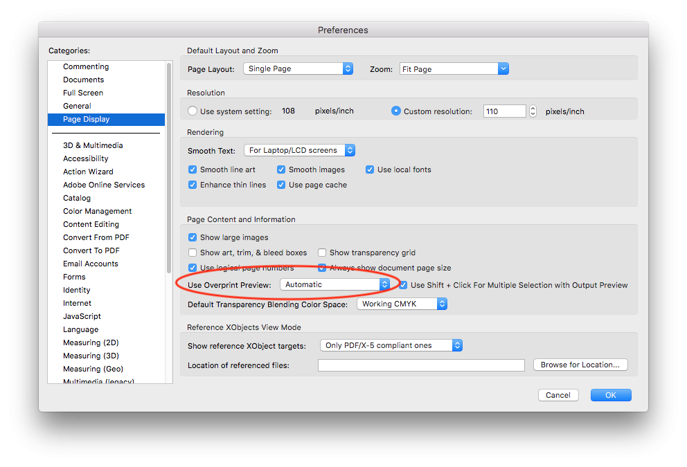

The overprint setting you need to be concerned with is in the Acrobat Preferences.
Well it won't fix the issue but it should show you the true representation of the file. The missing text was probably originally black set to overprint. Then changed to white and overprint wasn't changed. You can change the file via Pitstop or Acrobat Preflight and any modern workflow should have a setting that looks for and fixes white overprint. This is an old problem that has fixes for it many different ways.
