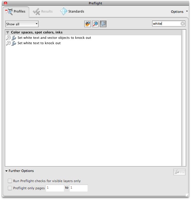

I agree with Lukas that PDF/X standards are a good option. Another is using presets from the Ghent PDF Workgroup.
Acrobat Pro has some good preflight profiles and single fix-ups, a screenshot is attached.
