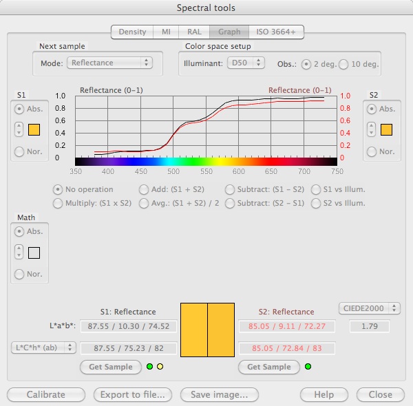

For those still with us, here's my sample matches of PMS123 on coated and uncoated stocks compared to their respective pantone guides. One ink mind you. Each thumbnail compares the Pantone guide measurement (black) to my sample (red). Its evident that an acceptable match was obtained for both coated and uncoated, and I have no doubts that this can be achieved in production. Yes, its true that ink film was increased on the uncoated sample, which should be no surprise to printers out there, as ink volume needs to increase to compensate for absorbency of the uncoated paper. This occurs in process colors as well. Uncoated paper requires more ink even to maintain less density than a coated paper. Printing at the same ink film on coated and uncoated isn't realistic. You milage may vary on your paper stock with your ink, but the guides themselves are not out in left field.
I don't expect this will abate the polemic against Pantone, but thought I'd throw out (again) that this isn't an impossibility. I do agree that Pantone isn't perfect, and maybe you'll have more luck with the GOE guides (or see more of the same). For us here, we print Pantone colors of all varieties and only rarely have matching problems...mostly with metallics.

Prepare slip sheet stacks and alternately impress any coated and uncoated stack.1) Run the ink film to match the Pantone 123 C book and compare your same ink film on the uncoated sheet. 2) Using the same ink run the Pantone 123 and visually match the uncoated book. Compare this Uncoated match run now to the coated. LOOK at it. Now hopefully using a critical test form with fine reverses , vignettes and small percentage highlight dots, LOOK at your print test piece and tell me about the quality of your print subjects. You will have NO ANSWER, with a one ink entity.
I expect you will not do this and just offer more of your contrary opinions and try to support it with more non practical Lab values that most readers will not, do not and cannot understand from a laymens terms to produce sellable printing. You are very much a contrarian Med, close minded and it shows throughout the replies you have posted at Print Planet. I do not reply to posts where I am considered by myself, to be a non expert. You reply to most posts, because you are the Godof printing in your own mind and may think that Alois Senefelder is one of your ancestors. Stop being a know it all and LISTEN and respond responsibly when you have some TRUE knowledge to share. If you don't heed this advice you will be known as a fraud and people will respect you less and take your advice with a grain of a salt. Respect this. D

I agree with you that there are different ink film requirements for coated and uncoated and thought that was evident from my posts. At coated ink films, the uncoated sample will look weak (though still red), and at uncoated ink films the coated sample will be oversaturated and likely will have drying/set off issues. I still maintain that sellable printing is possible for coated and uncoated at their respective ink films, closely matching the pantone guides. If you've done this test yourself, share your results (a scan of poor image/type reproduction, density or lab values if your able, something). I'd be interested to see and am certainly open to bring proved wrong (without taking it personally).
The rest of your post doesn't dignify a response.
