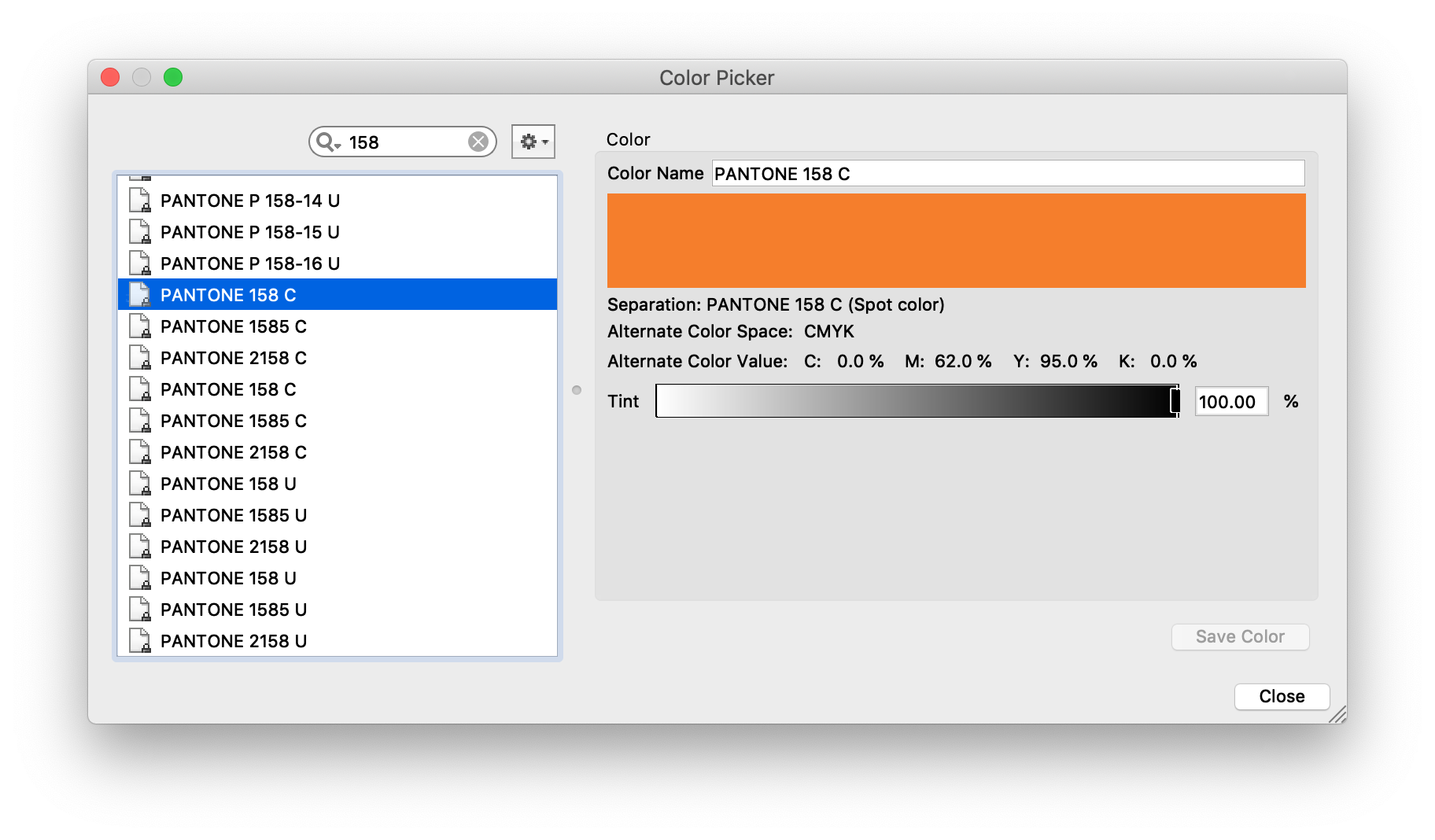

I have recently noticed a change in Pantones percentages in Pitstop Pro. Normally PMS 158C would be M: 62% Y: 95%, but now there is another PMS 158C showing up that is C: 2.8 M: 66.1 Y: 98.8 and if I highlight the color and choose the original PMS 158C, it doesn't change to it. I have to switch to another color and then switch to the original.
Can someone explain this to me?

What library is displaying C: 2.8 M: 66.1 Y: 98.8 ?
Both Colorbridge and Pantone+ Solid coated V3 are displaying M62% Y95%

Not sure why your Pitstop has changed, but can tell you that Pantone has changed the values for 158C. With V3 of the color libraries it was 0-62-95-0, and then when they updated to V4 it became 0-62-97-0. Like Gordo, don't know if anyone can explain Pantone, even Pantone themselves and why/how they are now doing the things they do.
Wondering if your Pitstop was using the LAB values and then changing to CMYK?

The files in question are created by an ad agency and they are using Photoshop to make the spot colors. When I get them they say PMS 158C, but have the mixture that includes 2% Cyan. I recently updated to Pantone v3 and that is when I started noticing this.
