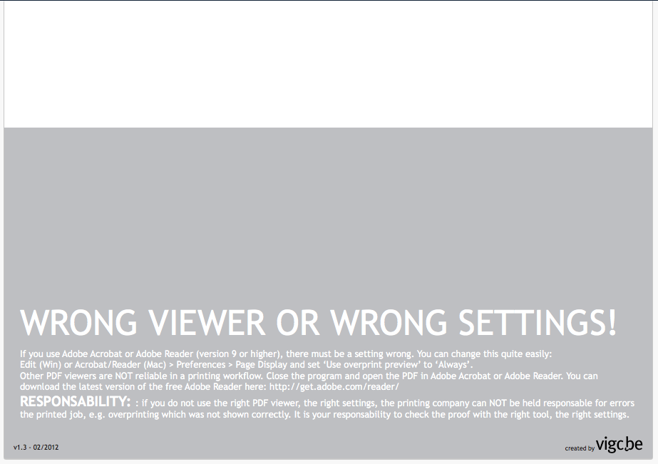

Well the Mac version failed the VIGC overprint test file that I have been suggesting is inserted as page 1 of outgoing PDF proofs!
Re: VIGC
Looks like it failed spell checker as well. Responsibility is spelled wrong. An oversight of that magnitude inspires little confidence.
The PDF can be edited/corrected or you folk could make their own version easy enough. It is a proactive move that is better than nothing. Although English is a global language, I cut the Belgians some slack for a typo not in their native language.
This PDF viewer also fails the Global Graphics overprint test, and it also fails the Ghent Work Group overprint test.
It does appear to correctly render multiply blend mode on CMYK objects though, for what that is worth.

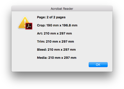

Although not in the same class, Acrobat Reader can run a script to show the various page boxes for the active page, which again is useful for a CSR with only Acrobat Reader (not intended for clients).
Click image for larger version  Name:	numPages.png Views:	1 Size:	30.2 KB ID:	276434
