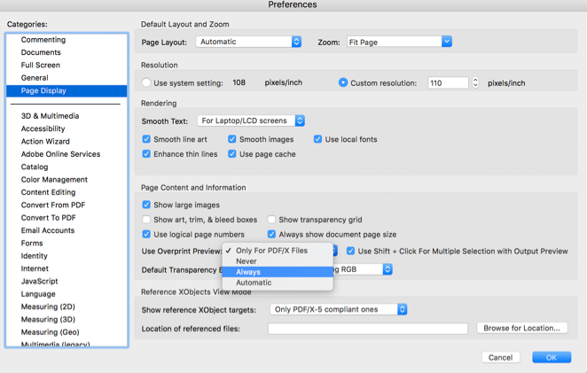

I'll use screenshots and type out exactly what they need to do:
In Acrobat, open the Preferences and under "Page Display” category make sure the “Use Overprint Preview” is set to “Always”. (See Screenshot)
