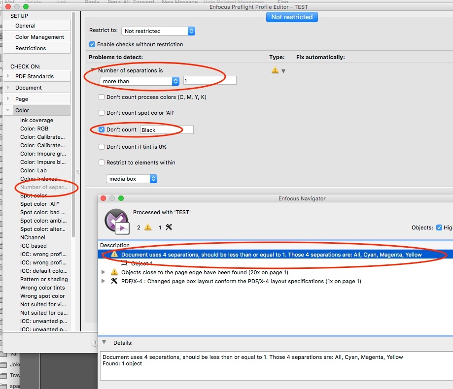

Why not something like this (image attached)?
