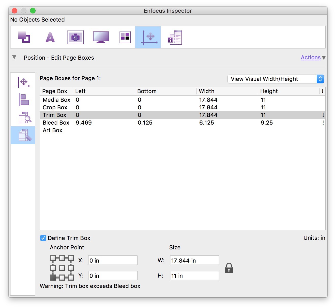

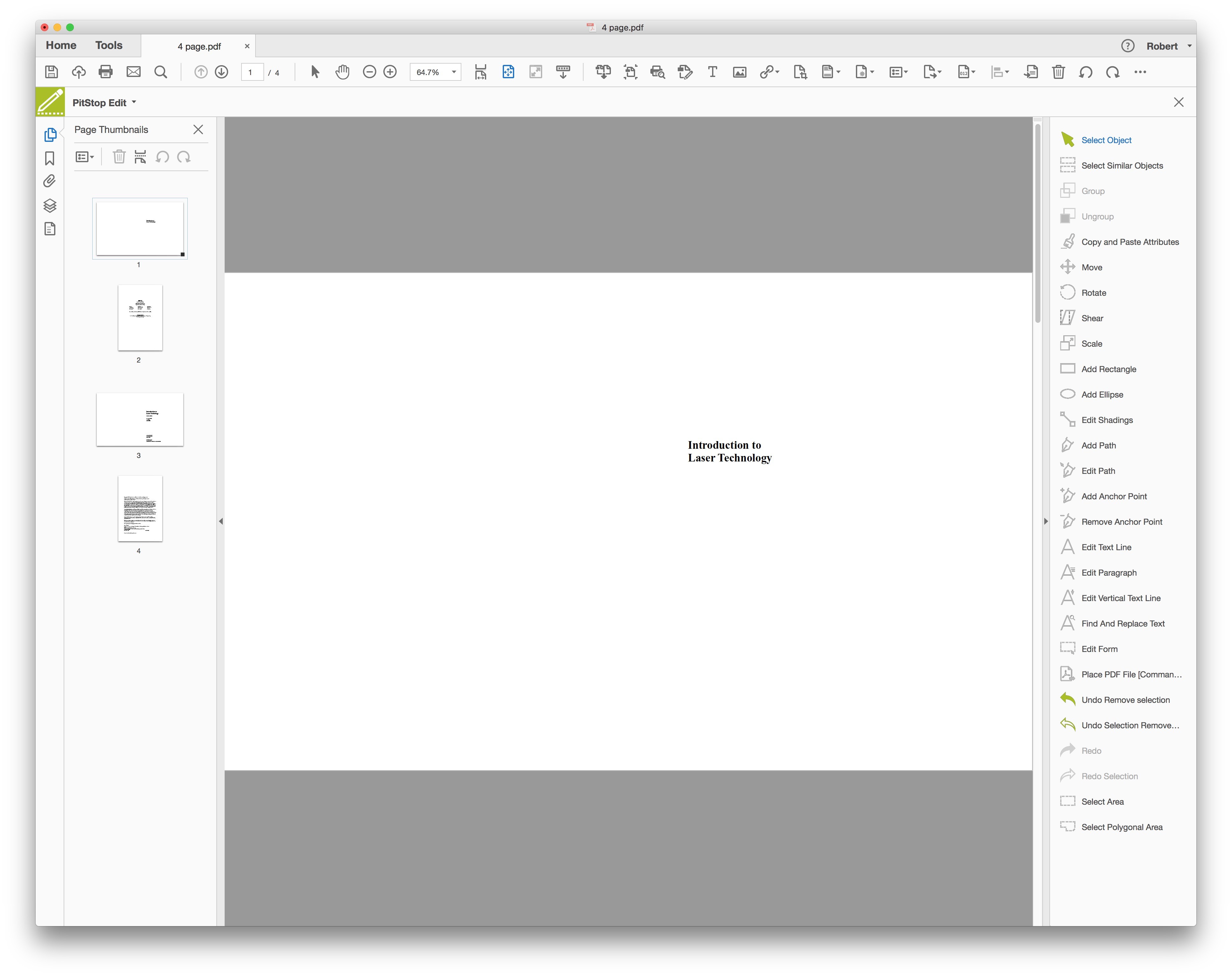

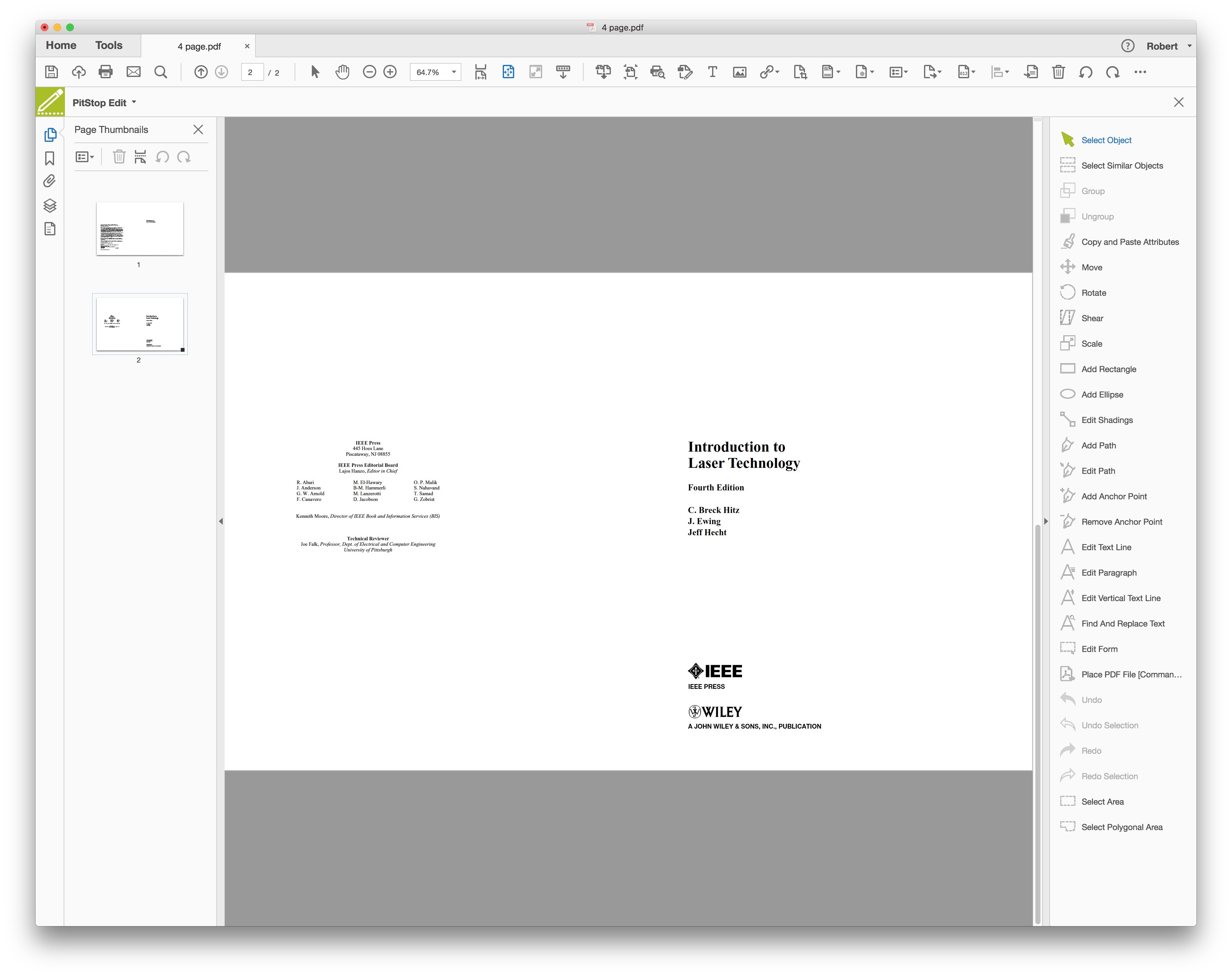

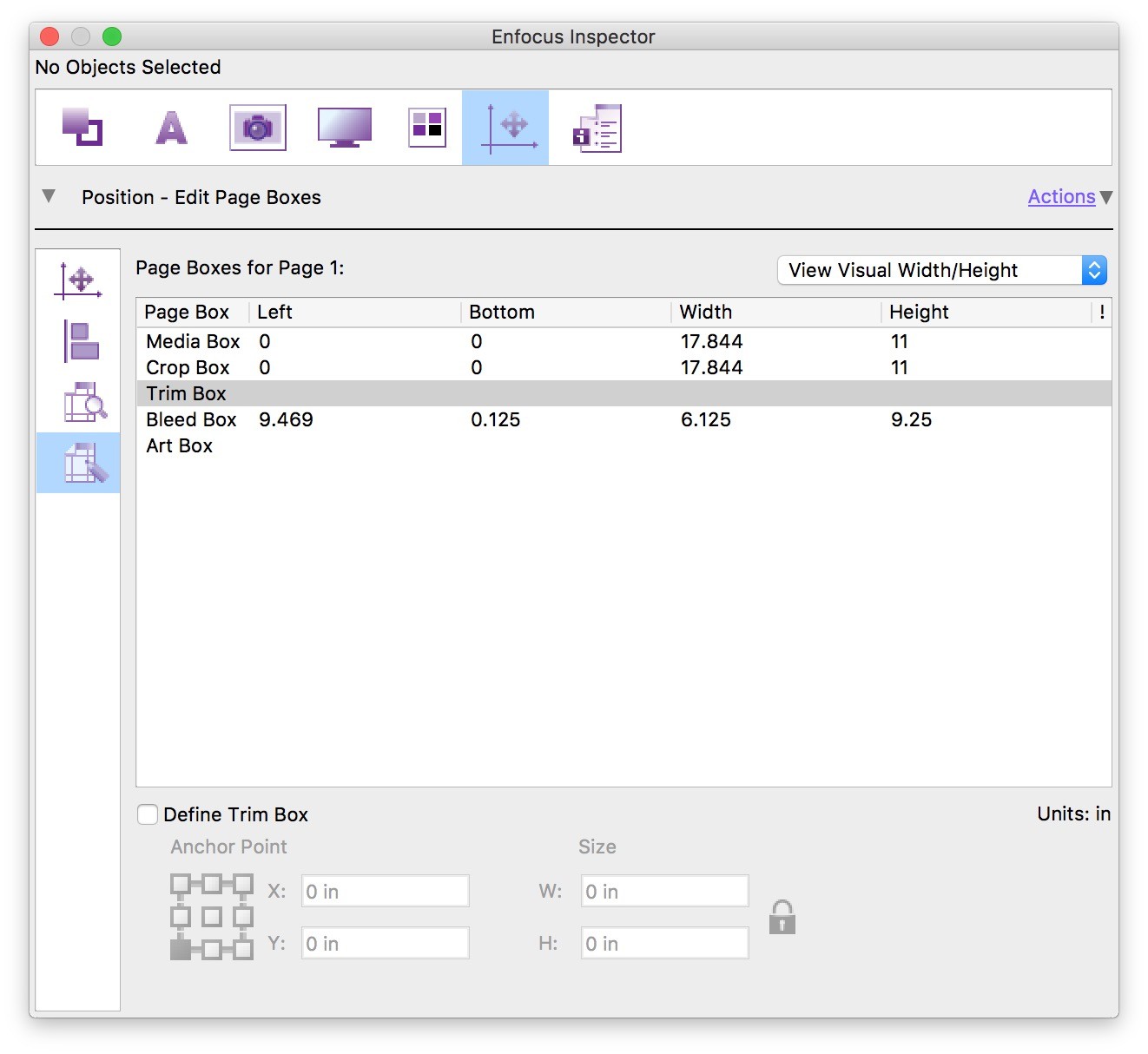

Thank you all for this action. Very handy. I have a question regarding a spread where this action may be expanded upon for my use. Any help would be appreciated. I have a 4 page document that, in order, page 1-cover, page 2-inside front cover, page 3- inside back cover and page 4- back cover. I run an action that creates a spread on page 1 and 3 with appropriate spine size (dependent on the amount of pages in the book so spine size differs per document) for a perfect bound cover. After running that action I have to manually copy and paste page 2 into the newly created page 3 "spread" and than copy and paste page 4 into page 1"spread". In order for it to paste correctly into either page 1 or 2 in the desired position I use Enfocus Inspector and highlight Trim Box and de-select "Define Trim Box". After copy and pasting pages 2 & 4 I than delete those 2 pages and end up with the resulting spreads that I need. I have an action that creates the spreads (an action per spine size) and an action that deletes the two pages after pasting but what I don't have is an automated way to paste pages 2 & 4 into 3 & 1 respectively. Can an action be created? I know this is a long explanation of what I'm looking to do so thanks for your patience.

I have no problem pasting in as long as I select the Trim Box > de-select "Define Trim Box" in Enfocus Inspector. It always goes into the correct position that I need. I was just looking for a way to automate it. Thanks abc.

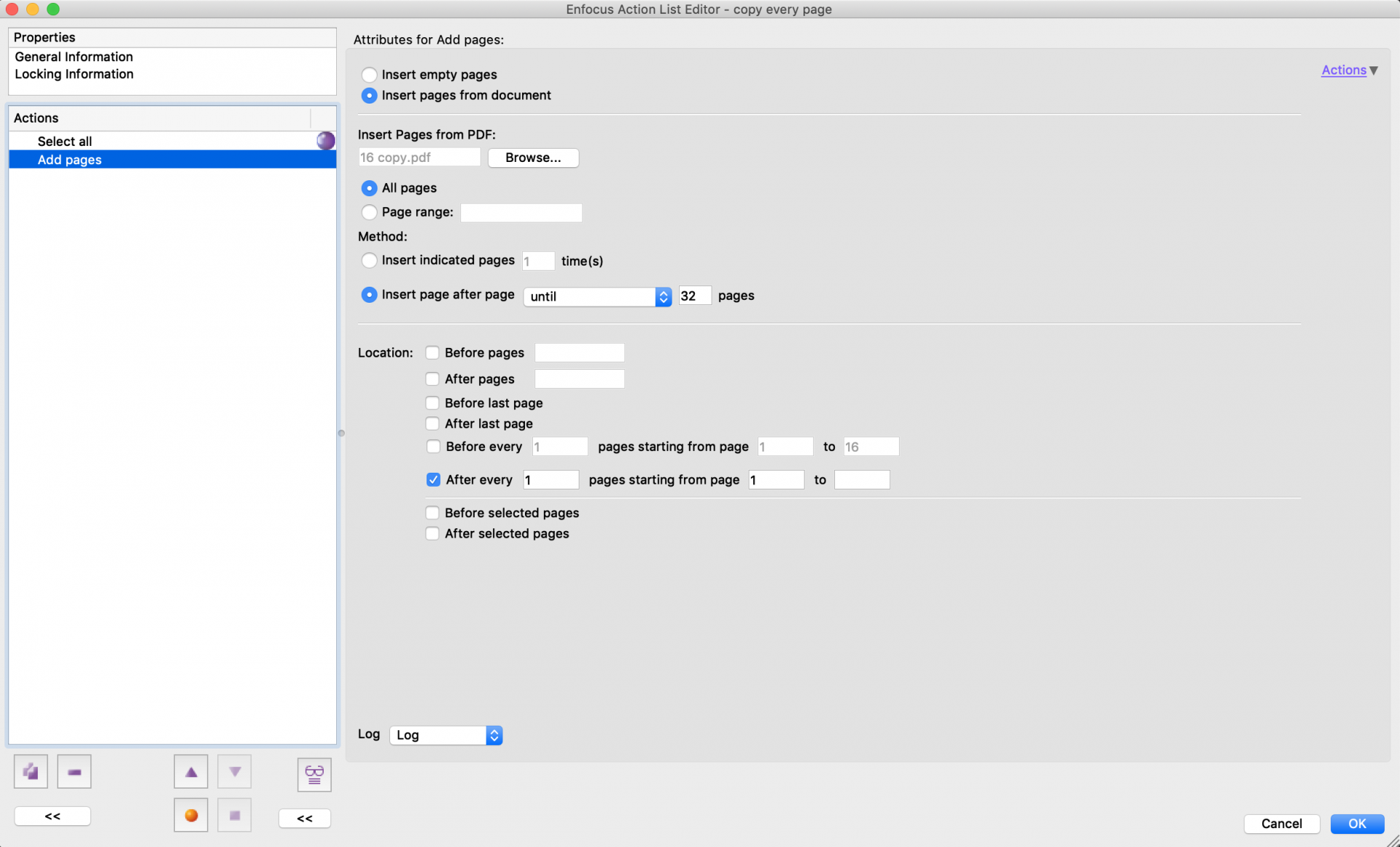

I have a similar problem. I have a 164 unique page document, I need to duplicate each page. so it goes 1,1,2,2,3,3, etc. is there a way to do that in pitstop 2017?
Joe
Not sure if it will work in Pitstop 2017 but if you have the add pages action that is in Pitstop 2019 you can create a copy of the document you want to duplicate and then create this action. Select 'Insert pages from document' and then point it to the copy of the file you are modifying and change the settings as below. They will then come out as 1,1,2,2,3,3, etc. Also change the value in the text box from 32 to whatever your total number of pages will need to be. For your 164 page PDF that number will need to be 328 which will be the total number of pages after you duplicate each one.
