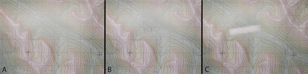

Has any one experienced ink adhesion issues with polypropylene substrates such as Yupo. We found that the ink from our previous products can be removed for the substrate with a standard eraser. I've attached an image showing the result. A: clean, B: wrote on surface with a pencil, C: erased the text with an eraser, which also removed the ink. The ease with which the ink can be removed is a bit concerning, especially for long term durability and am wondering if anyone else has experienced or noticed this issue. We found that adding a coating alleviated the issue but that's an additional cost.
