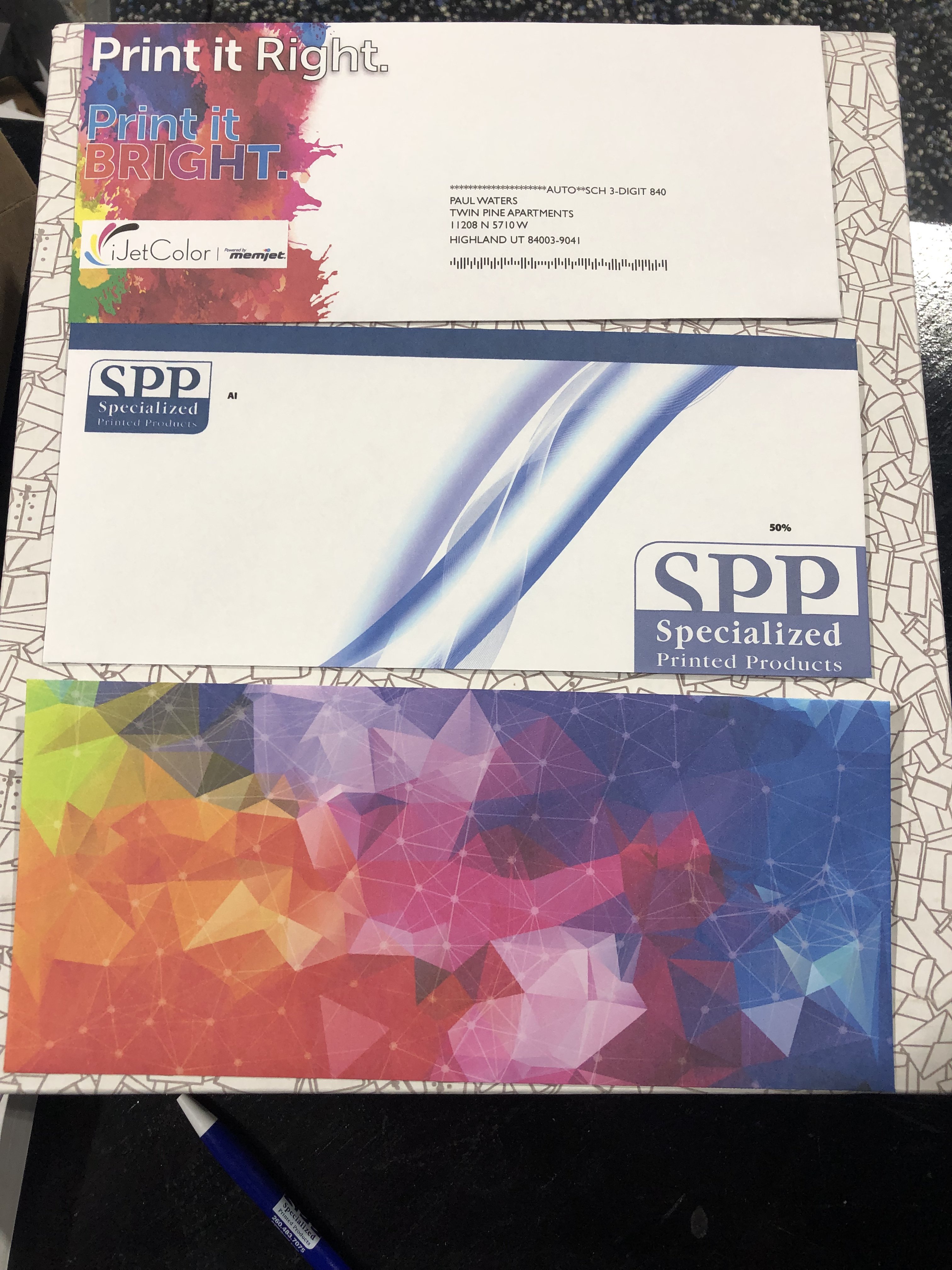

We did quite a bit of full bleeding testing and didn’t have any over-spraying in the belt. He showed me the waste ink catch and it seems like a good setup, but I don’t personally know how it compares to older models. I wish I would have taken a picture of it before he put the printhead on, because he explained how it worked during setup
I have not personally run variable data on it yet, but we will be. The main issue with running variable data is the size of the PDF generated, because it’s generating a page for every address and you’re going to face some buffering in high resolution mode. It prints fine in production mode, which is just slightly less quality, but will be fine for anything we have going in the mail.

Does it have a fiery? If so use the "Overlay feature" so only th veriable is sent for each page
It does not have a Fiery. It uses a Xitron Navigator RIP. I personally love the software. It’s more user friendly than Fiery. We have 4 Fiery servers in the building and I’m not thrilled with it.
I did finally print a variable data job and the buffering wasn’t bad at all. It did not slow down production at all. Every 50-60 sheets it paused for about 1 second (enough for one single envelope pass). When he said it would buffer on variable data in high res mode i thought he meant significantly. We’ll be just fine printing variable on this. :)
