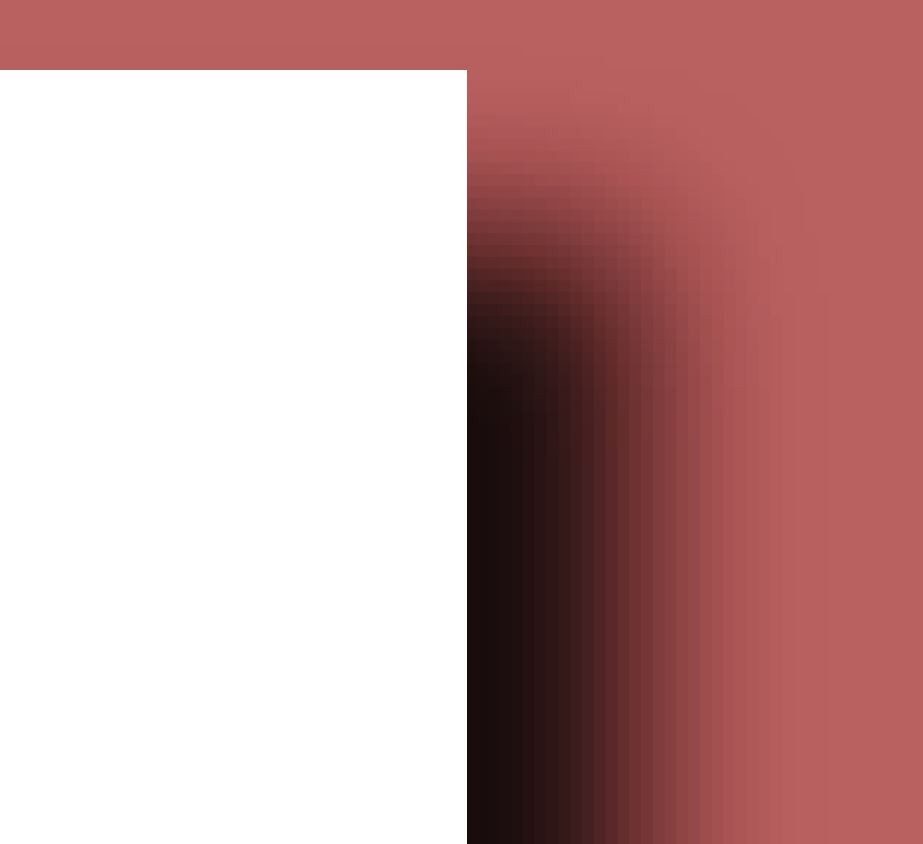

Acrobat DC version 2018.011.20063. Separations: CMYK + PMS 2032 C. Shadow overprints spot as black only in both photos.

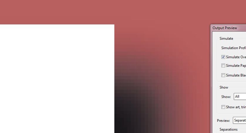

Well, if you ask how it appear "visually" — in acrobat dc 2018.011.20063 with overprint preview window on it feels like it knock's out 2032 pantone. Without overprint preview window on it looks like overprinting 2032

Weird. I have the same version and the black shadow overprints whether I have output preview open or not.

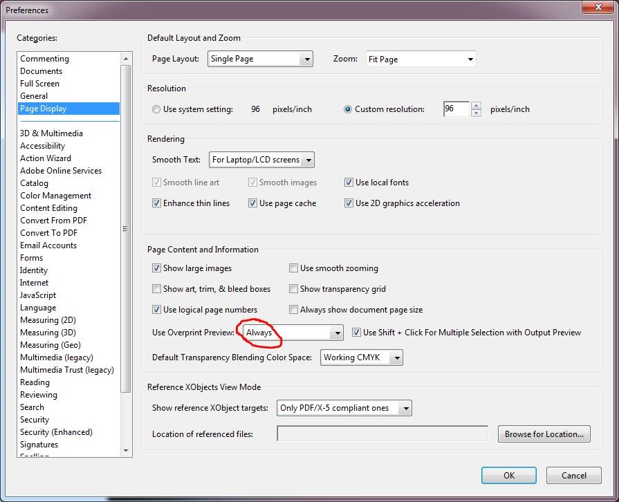

I don't think it's a bug. If you want to see it similarly with op window on and without you should go ctrl (cmd)+k —> page display

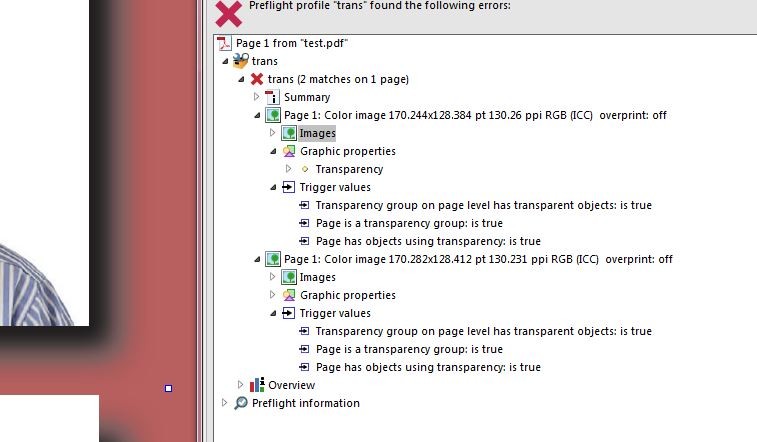

Well, technically it should show like"no overprint" 'cause there is no overprint on the image

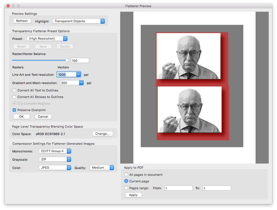

No there is no 'overprint' of the shadow. It is 2018. The shadow is a transparency effect that allows the shadow to print over the background color. When I said it overprints the spot color, it does. But not because of an overprint setting but because of transparency.
The area in pink is the transparent region which is the shadow area. You can view where transparency is in a PDF with the Acrobat Flattener Preview tool.
