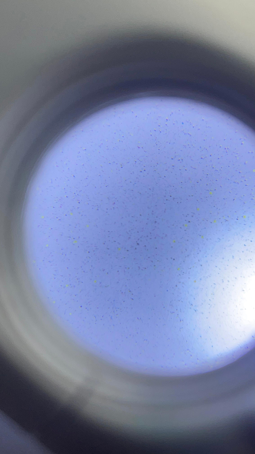

hello, I still have the problem anyone have finding a solution of this issue, the light background i have is from all color cyan, magenta and black point
Please if there is a solution pls pls
This is a photo zoomed of dots i have in all background of sheet edge to edge
thanks for your help in advance

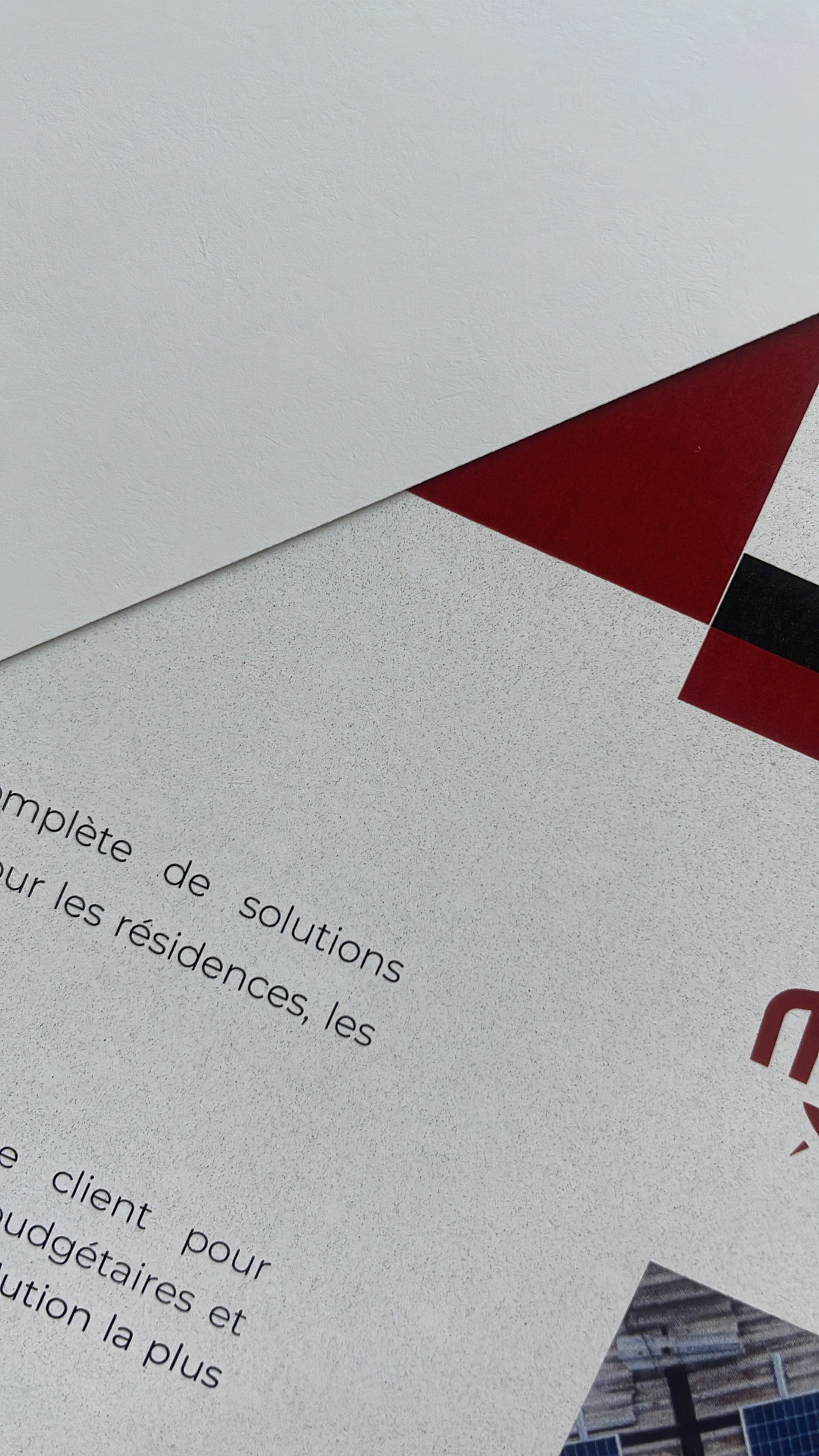

I have the same problem on my 4100. And it didn't do it before. The technician also does not know what it could be due to. Did the IBT change solve the problem?
Hell, the problem is begin to be big as you can see in the photo
