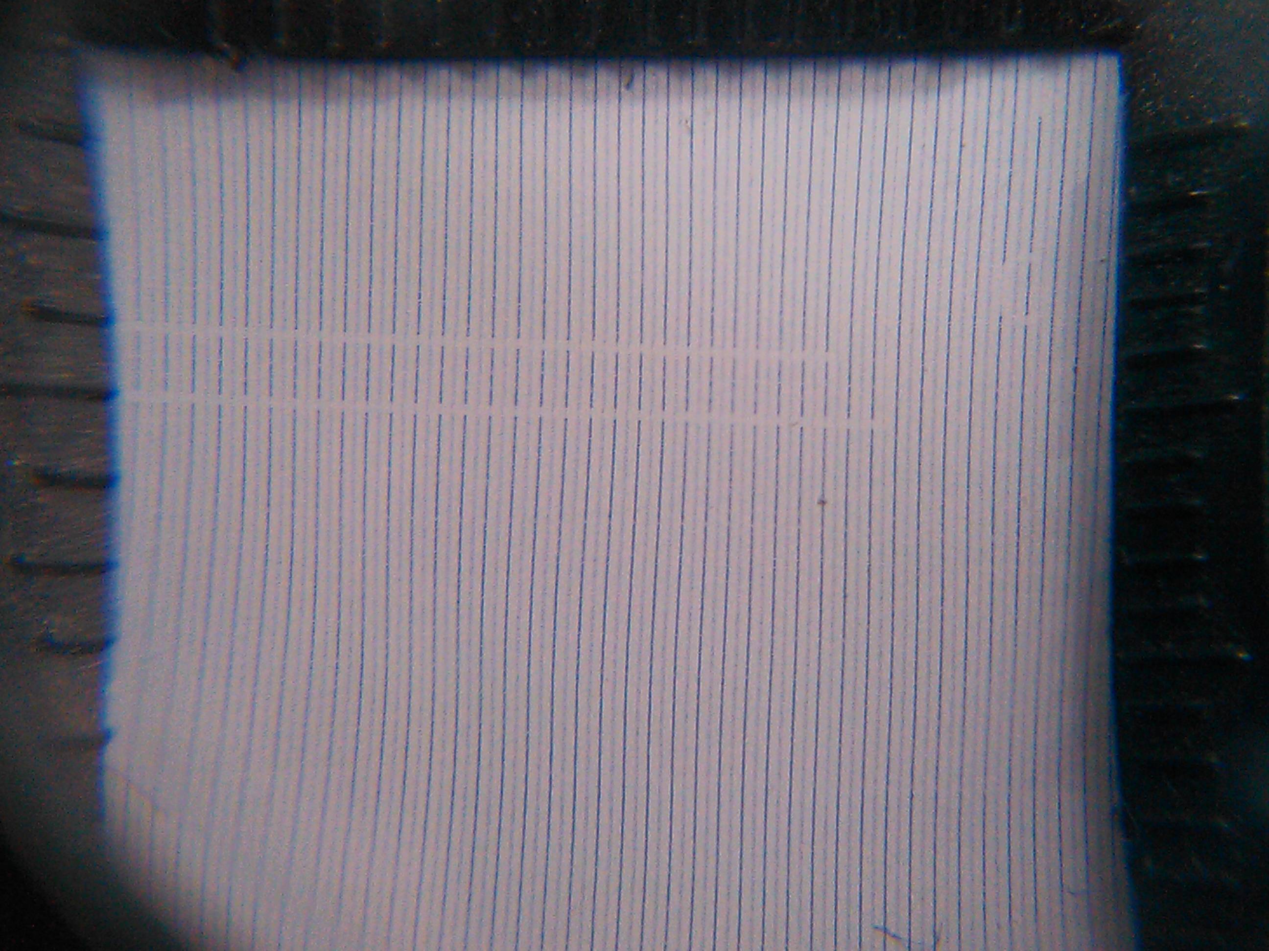

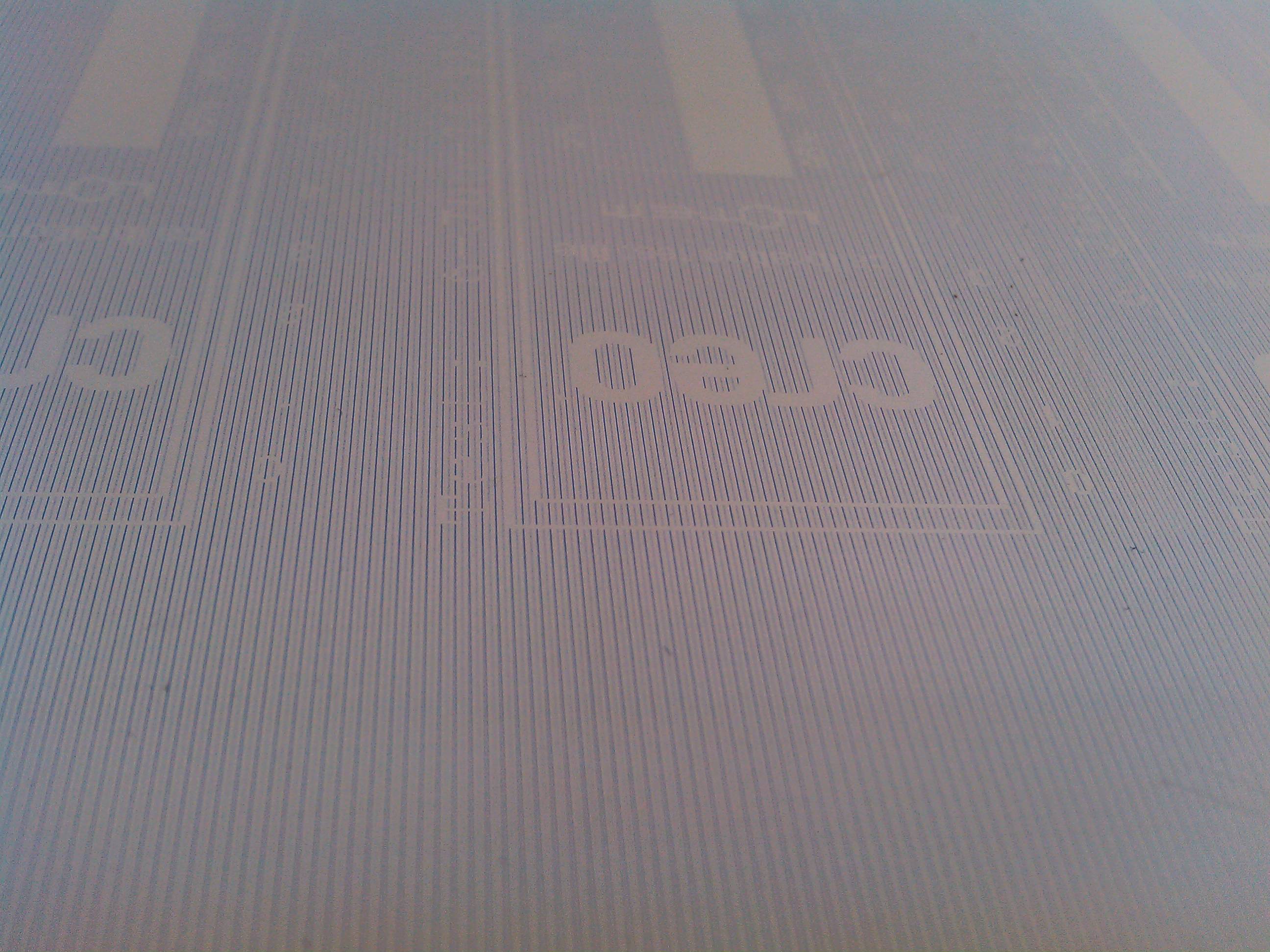

problem whit vertical lines on LOTEM 400v!!! HELP!!!
milos Newpress
Does anyone have an idea what it could be
hey guys recently i've the same issue .. if anyone please help us here !
hey guys please anyone help me here , i've the same issue (lines vertical ) with definite spectrum of dots for examples
nohting appear wrong with pantones and solid dots , and under 50 % shades , other wize it's awfely appeared specialy with the 70 x100 size plates , tried anew system for the machine a new expose but still exist , any idea or help appriciated
this is Lotem 400v - fiber - no beam balance - looks like diodes misfiring - probably DDB card gone
