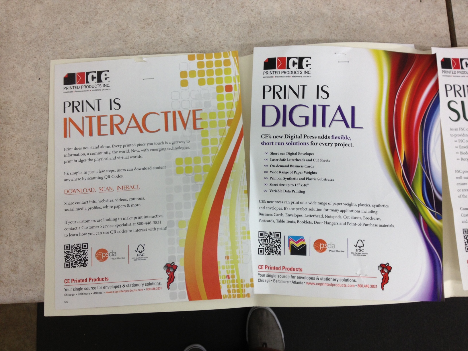

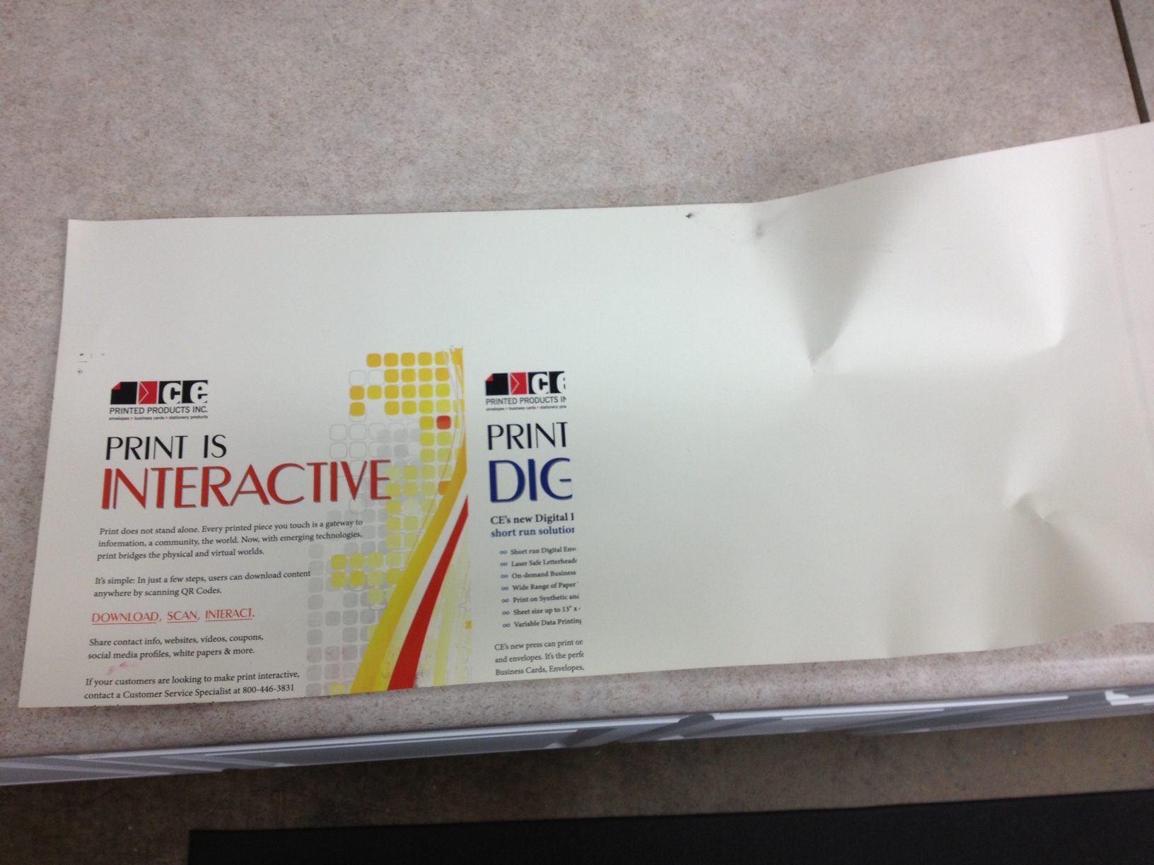

My issue is that when I rip a file larger than 13x19 it only prints a portion of the image at a size of 8.5x11. I have attached images of what is happening, the first image is roughly what the file looks like (i know the image is just pages stapled onto a sheet but the file is the same layout), the second image is how it is printing out of our press. I currently have no issues ripping and printing anything smaller, this only seems to happen on larger format prints. I have tried multiple files however, as long as the image size is greater than 13x19 they all seem to produce the same results.
