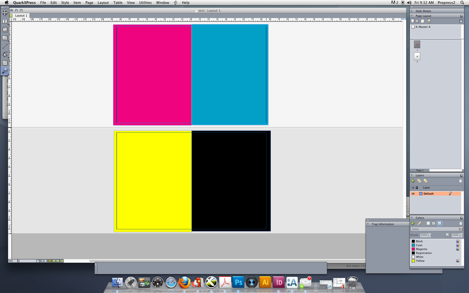

Maybe.... I tried printing them to a pdf and used manual tile. On a spread built 17 x 11, I printed to a 8.75 x 11.25 pdf with 1/8 inch bleed and set manual tile to get the left half of the spread. I then moved the x coordinate to 8.5 and print again to get the right half of the spread. Results attached. Try it and see if it will work for your set up. You'll still have to paginate them in correct printers's spreads, but maybe this will work for you.
