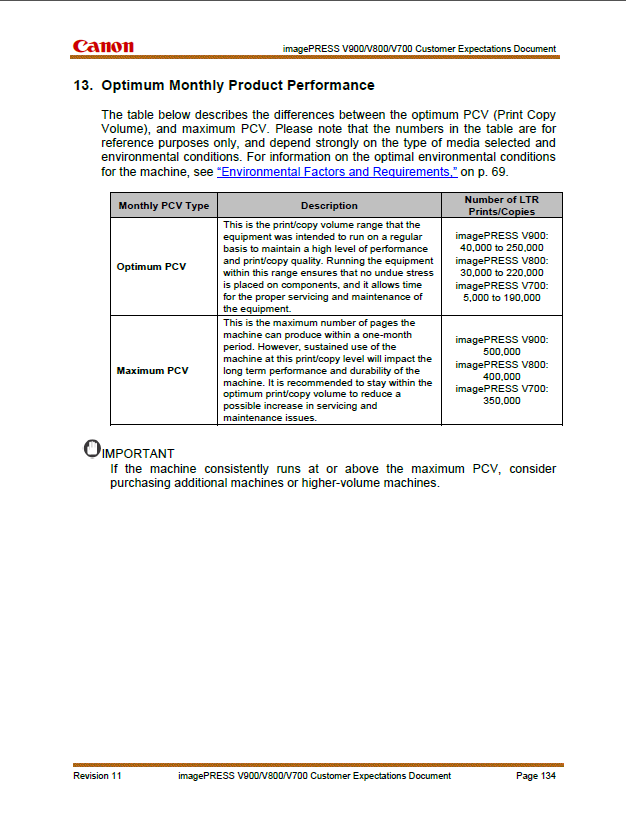

I'm getting told by our Canon Sales Representative that the v900s are rated for 250k impressions per month BUT only for 8.5x11 plain letter paper.
My Math is this:
  • That would be 125k Impressions on full sheets (at most)
  • Salesperson says running 12x18 - 110lb or 130lb Coated media that lowers the threshold even lower.
  • They recommend only 100k impressions per month per machine.
  • By my math that's roughly roughly 4000 clicks per day per machine or 2000 sheets of double-sided prints on cardstock.
Does that sound about right to everyone? I'm just trying to gauge whether or not the salesperson (who is pushing for us to upgrade our printers to higher volume) is being reasonable or if I'm being unreasonable in expecting more.
Your attachment shows 500,000 max pages that's 250,000 2 up (full size) and cut again for cover it's still double your math. But yes that kind of volume go bigger and faster you will probably get a better click rate too.
