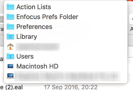

On the Mac, in User > Library > Preferences > Enfocus Prefs Folder > Action Lists as in the attached screenshot:
Stephen Marsh
