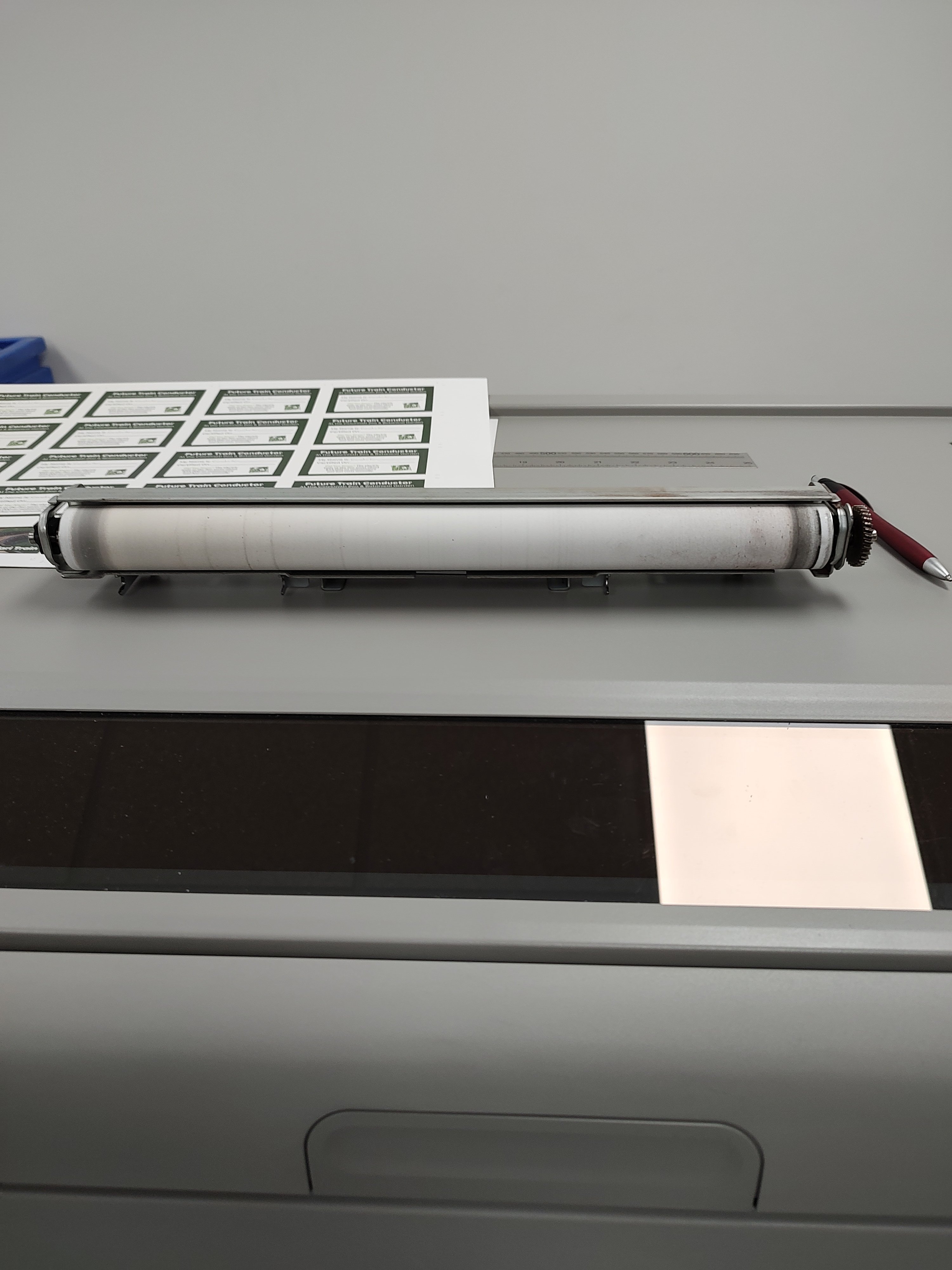

We are getting lines in our fusers belts and going through them so fast our service provider is telling us we may have to start paying for them. I have 3 fusers on the floor for the 9210. Techs have advised us to change the fuser for the various sheets sizes. Well our manager will not let us do that. I know what a sheet edge "line" looks like, but the belts are getting fine lines all across the belt and the edges look rough from the sheet edge lines. Any advice would be most appreciated.

I can swap out fusers no problem. I learned to swap fusers and change alot of my parts thanks to online videos. We try to minimize down time and not call service if possible. Plus I like reading the manuals.
The solution is either don’t run mixed sizes or swap fusers when doing so. Or just tolerate it. Waiting for service to fix every time when you have fusers on the floor you could swap to is just silly. Let service bill you for it, I bet the problem will solve itself (management will then decide it’s okay for you to swap).
Honestly, 99% of the time for what we do, it doesn’t actually matter and I do not stop production over inevitable lines. Postcard is going through the mail? - the fuser line will never get noticed.
I'm not an expert on the 9210, but, I tend to agree with @Stickman42
If what you are describing is a "grid-like" pattern, that doesn't sound like a fuser problem.
Is there any way to stop (interrupt) a page after the charged toner application, but, before it enters the fuser, like, force-opening a door or something?
If so, do the lines appear on the page?
