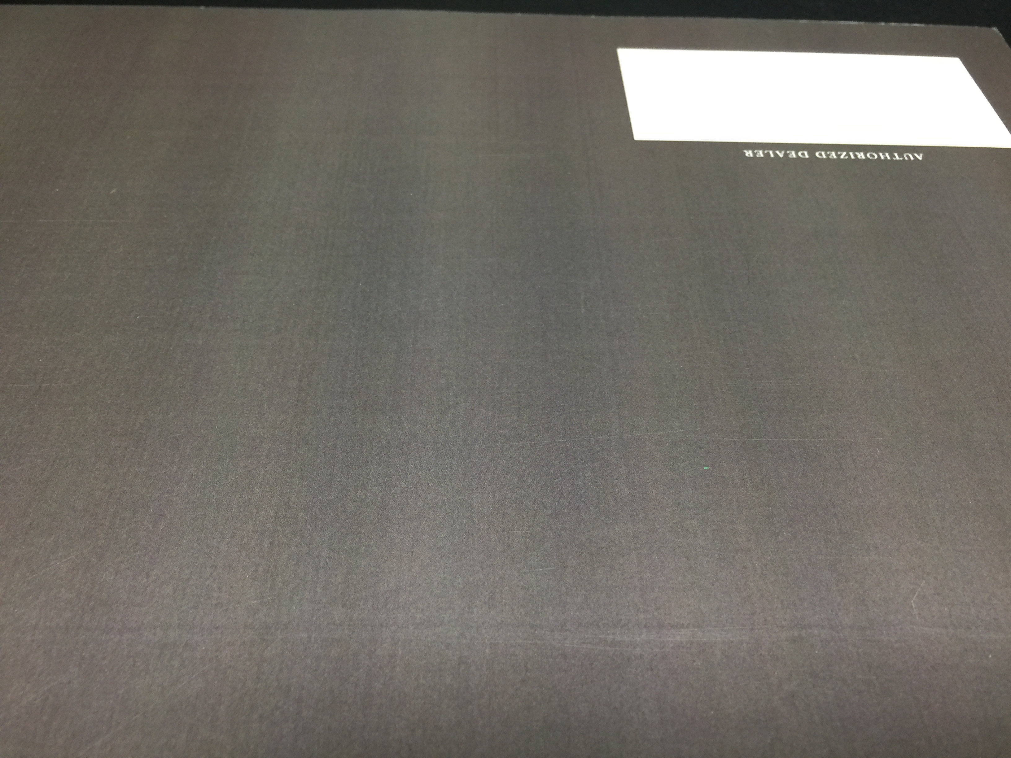

Here is an example of the 3100 banding.

Hi, this shows your drums, one or many, needs to be changed. Print a 40% of each primary and you'll know.
Id say no, Looks like you need to clean your sensors and check drums and other areas for damage or dirtiness. Those are streaks, not banding.
In the Custom Paper Settings you'll find a setting called Trail Edge something. Set that to 70% and you'll solve the edge problem there. For that band, get your service tech to look at that. I don't have those.
Actually that banding is mainly developer housing with that frequency of occurrence. Having to replace them so often is the real pain with this machine and the drums have been terrible lately which makes one wonder if they are a contributing factor in developer housing failures.
