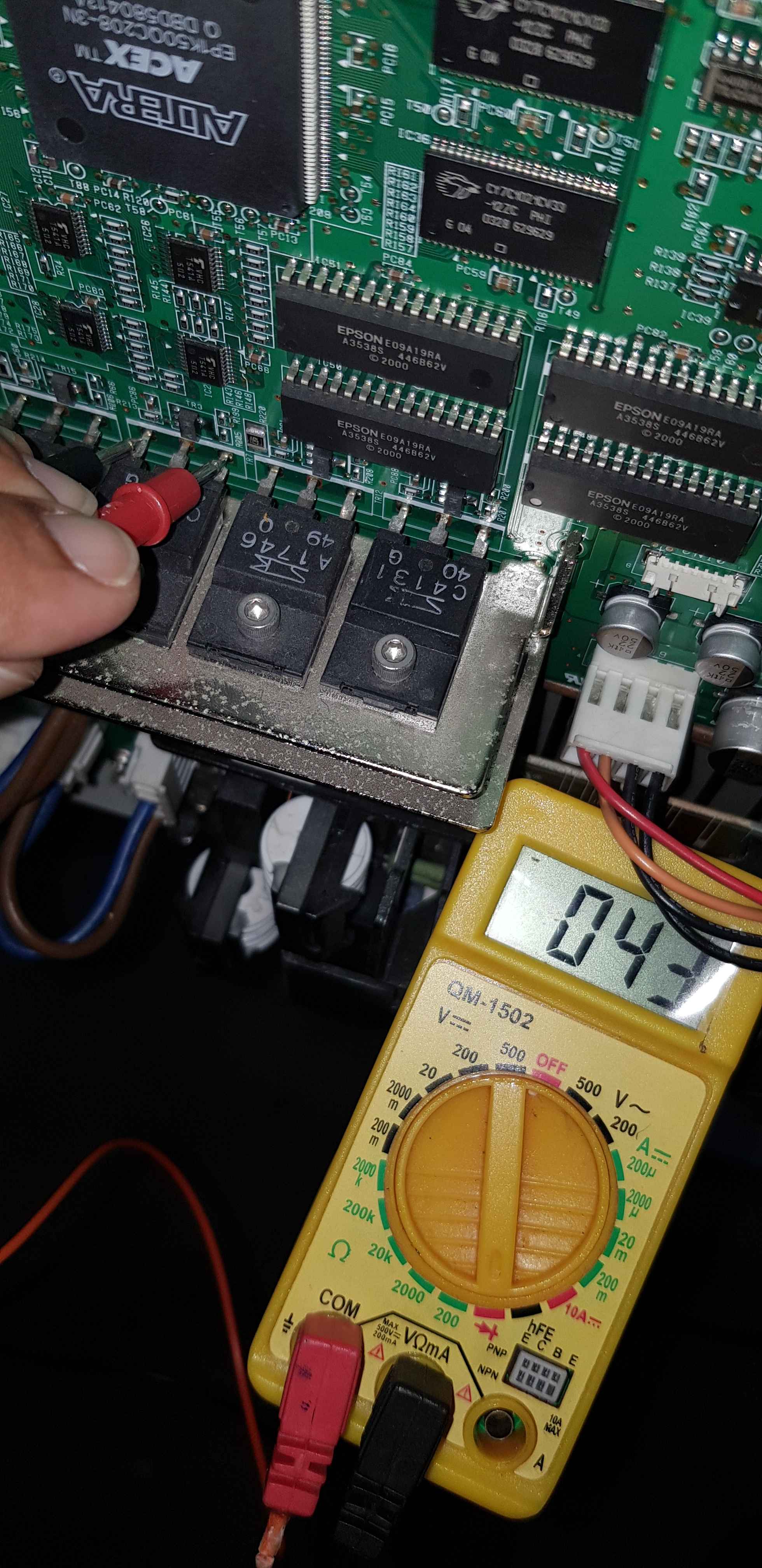

3. Reading forum comments here I did a check on the 8 transistors and they all show 43 on the two end legs of each transistor. I assuming they are not blown?
